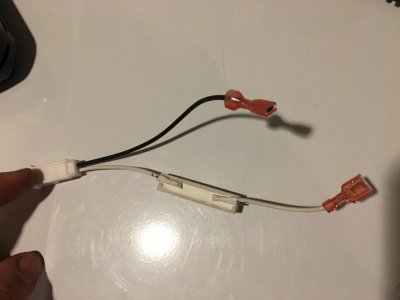

The resistors I used were ceramic and about 1.5” long and 3/8” square. Did not require additional wire as the resistor connections are metal and fold in on the resistor so your really only adding 1/2” or so to the length. I did this in the metra adapters so the stock wiring is untouched.
Here’s what I did, I also have a thread on it here.
https://www.ramforum.com/threads/adding-a-resistor-for-4-ohm-dash-speakers-works.100172/

Thanks for the pic. I found some resistors at digikey.com that resemble the one you used. They are $.63 each. I think I'm going to buy a couple of those resistors and another set of Metra adapters and give this a try.
https://www.digikey.com/product-detail/en/yageo/SQP10AJB-3R9/3.9W-10-ND/18725
