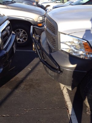

I went and did it.
It was easy to install. The center connections go into the license plate holes, a little tight but go. I just drilled 2 more holes on the ends. I'm putting pro comp HID on the light brackets. This is a quick pic. ImageUploadedByTapatalk1445654859.006755.jpg
HemiPower36
May 16, 2014
1,424
839
CA
2014 Ram 1500 Laramie 4x4 3.92 8-speed
Nice, thanks for posting it up, post some more photos when you get the lights on.

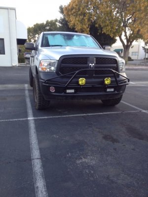

I put on ProComp 4" HID. I'm going to change how the wires route but this is how they look. The light output is great too. ImageUploadedByTapatalk1447772519.450002.jpg
darkknight
Jun 23, 2014
154
35
5.7 V8 Hemi
That looks good. Do you have side pictures. I am thinking of running this rather than a bull bar.

darendeath
May 24, 2015
45
V6
Thanks
That's what I was thinking too. I like this look more. Sorry I don't have a good pic. I just took this in the parking lot. I'm going to put the wires through the split on the metal/plastic bumper fascia. ImageUploadedByTapatalk1448036170.154561.jpg
jonathanhudaon
Apr 14, 2016
128
16
Hey Darendeath, for the outside holes did you just drill through the bumper or did you have drill through the bumper bar as well. I’m looking to do one of these on my sport. I know they say you can’t use these on a sport but if it goes through the bumper. I may be able to make it work lol
