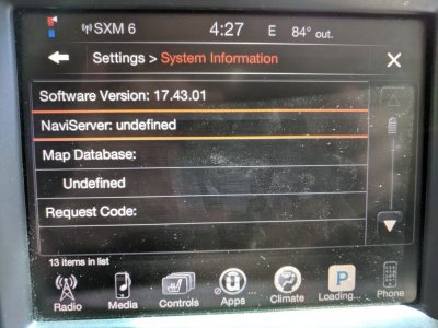

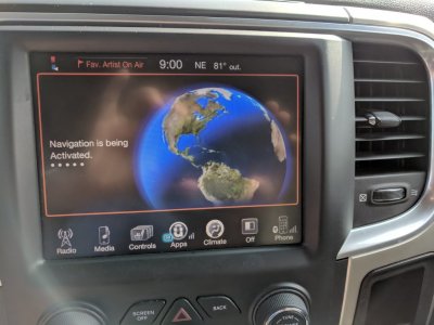

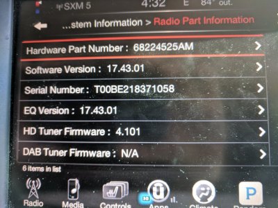

Hi,
I found your post on the form and wondered if you can help me, I have a Ram 2014 Outdorsman with the 8.4N Uconnect system Hardware part number 68224525AM. I downloaded and flashed the 17.11.07 update a few months ago and the 17.43.01 both from the Uconnect website. Upon installing 17.43.01 update I did a factory reset and lost my navigation I have a “Naviserver: Undefined” error and database is missing. I have contacted Uconnect unhelpful, except to tell me to take it to the dealer and said the unit had to be replaced. Everything else works fine. I also noticed the gps setting for the clock is also missing. I tried to flash the 17.11.07 but can go backwards. Any help would be appreciated.
Thanks,
Mike
