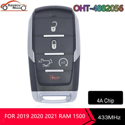

Need another remote for my 2021. Don't want to spend dealer prices. Yall have a reputable inexpensive place to purchase one from? I know I need to get it programmed unless yall have a way to do it without going to a locksmith or stealership? Lol.

This is the cheapest way to get a new remote for your truck and do it all yourself:
- Fob:
- JScan OBD app (alfaobd can not program a fob for your truck)
- OBD interface:
- Security gateway bypass:

Find the cheapest deal you can on an OEM Fob. It will be a LOT cheaper just to have a locksmith program it, unless you have a bunch of other stuff you want to program too. Option, check your locksmith's price on a new FOB, they then stand behind the FOB both for programming success as well as warranty. About 80% of non-OEM key fobs fail to program, the locksmith will charge you for the program attempt as it is not his FOB, or kick within 6 months.

Incorrect. Alpha OBD 100% can program a fob for his truck. I have the same truck and I programmed two new fobs after I lost one of my originals which I later found. So I currently have four fobs two from Amazon that were blanks unprogrammed.

3 Ebay keyfobs for Ram trucks. All 3 programmed properly.

This is a video I did of programming a fresh eBay fob with JScan just this morning (note the VIN, as it’s the same as the alfaobd attempt):
