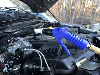

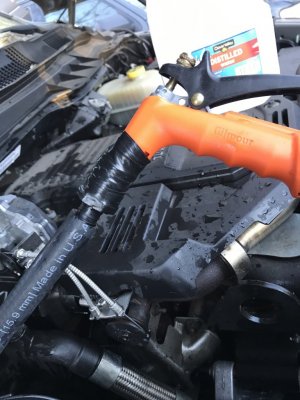

Update: I HAVE HEAT!!!!!
I flushed the Heater Core with water hose and air.
I did the flush both directions, several times. After flushing, I poured distilled water into the hose until it filled the heater core then blew it out. I did this 3 or 4 times to rid the core of regular water.
If I were going to do it again, I'd buy new clamps. The squeeze clamps are junk.
I literally have to turn my heat down now.
