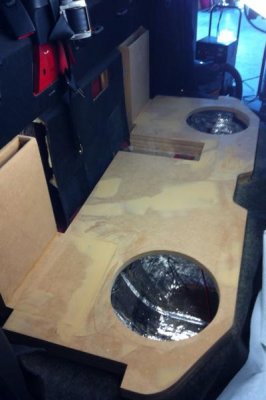

I was able to find a pic.
this is what i have seen
i used to build the boxes this way, just without the ports.
however i dont think you will get enough airspace for 2-12"

Maybe not ported, but def sealed I would. Jl recommends 1.25 in a sealed box and I can get that

I loved W3 sealed I wouldn't hesitate running them like that. I do know that most JL's like a little over recommended space but don't get to crazy with it as output will suffer at higher volumes.

I agree. W3's do very well in a sealed box and you should have no problems building a box with appropriate airspace for two w3's sealed. And yes, JL's do better in higher than recommended airspace. Unfortunately, that goes with ported boxes too. You will have a difficult time finding the airspace for two W3's ported tuned to 30hz....im not saying it can't be done...it'll be tough tho.
10W3's would be no problem
