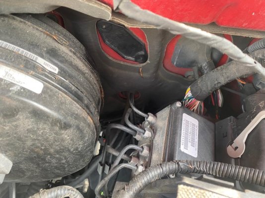

Can you circle or point to where I should be looking?
Thank you for your help.

I was not able to use that grommet with the nipple even though it is there for running wires out of the cab. I tried for no joke, a couple hours to fish some wires for my backup cam and I gave up.
I would recommend using the clutch pedal block off plate instead. Drill a hole through it, put a grommet in it and black silicone it all for water proofing. I believe JB1 used this plate to run wires for his lights, I will try to find the thread.
One nice thing about this plate is if you ever want to return everything back to factory, just get a new plate. I have a run of 0ga, 8ga and the backup cam wires running through mine.

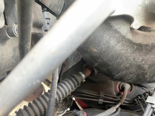

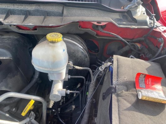

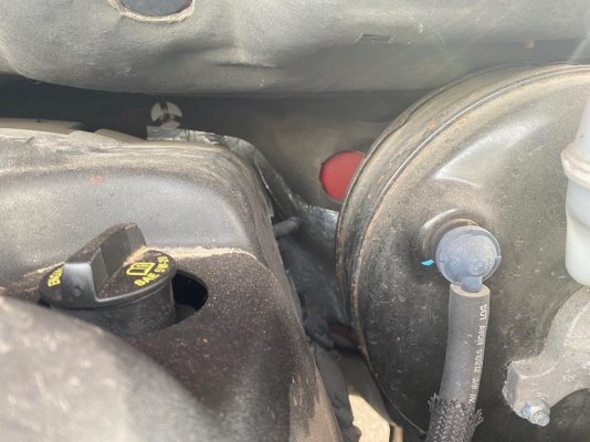

I think I may have found it.
Is this the spot?

Pic # 2 behing the big wire loom, you can see the nipple sticking out, need to trim off the end or poke a hole in it

Have you tried to fish wires through that nipple in the wire boot? I was able to get a screw driver through it but no matter how I tried to attach wires to it and pull it through, couldn't get anything to get through it.

Yeah - I did. Took me quite a bit though, wasn't easy. I actually ended up stripping a length of house wire and fished it thru first, then pulled the rest thru. It was a royal pain

I cut a 2” slit, on the inside and outside, used a metal hanger to poke thru, used duct tape to tape wires to hanger; pulled back out. Wasn’t as easy as it sounded but it worked. I’m gonna use some silicone when I’m all done to reseal it.

Sounds funny but KY is your best friend here. Water based, won't attack rubber products and will wash away or just dry up after a short time. Used it alot (or generic similar) doing car audio installs.

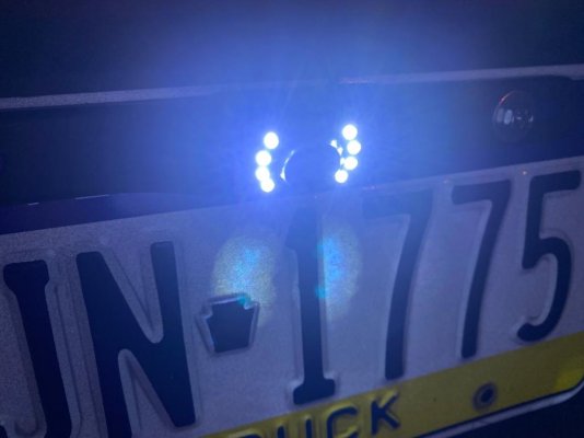

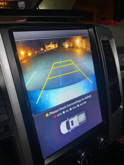

Those seem like your just asking for trouble during rain and electric storms, or near high frequency sites.
But I got it all hooked up, wires ran, backup cam works and for $28 it looks really good.
** After this picture was taken I adjusted the angle of the camera and it is pointed more up now and looks a lot better.

OnSale what head unit is that? It looks great.
