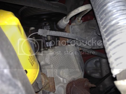

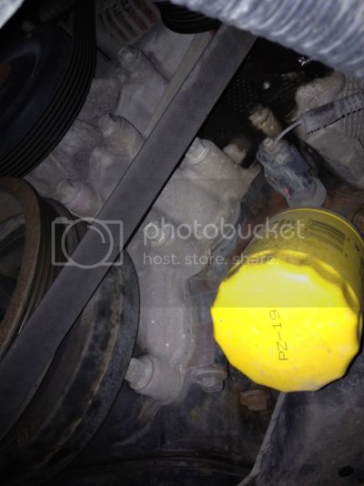

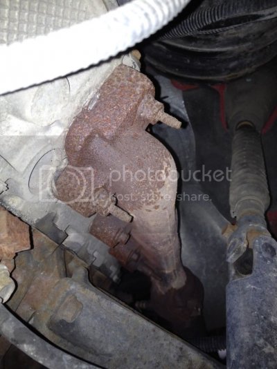

I am leaking orange fluid (coolant right) out of what I would think the main front seal? I have a small puddle in my drive way, truck has been acting kinda weird but nothing to complain about, Semi loss of power here and there. I have noticed the fluid around that area for a while now, Just never thought anything of it.
Is this a serious deal or just something that need to be tightened?

Looks to be coming from the crankshaft pulley area. But it doesn't overheat, I just drove it 20-25 minutes into downtown and it was fine. Stayed bellow half way. It didn't even act up this time....
Idk, maybe I am over reacting, but it seems coolant always means blown motor.
