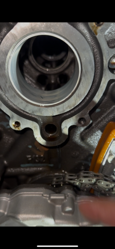

Hello friends. Need for you your help. A week ago my ram 1500 5.7 e torque 2021 started knocking. I took off camshaft that is damaged, but also found that camshaft bearings need to be replaced.
And I didn’t think that it will not be easy to find new ones.
All that I saw on market might not fit.
On rock auto when I choose by the model it gives me enginetech cc487, but I called enginetech to be sure that it will fit, and they said that the are not sure, ask a professional.
Also called summit racing and they said that they don’t have ones.
Maybe someone already solved that problem.

ThanksView attachment 559357
If I remember correctly the Sealer Power Came Bearing kit part number is...
1874M
