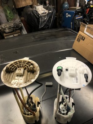

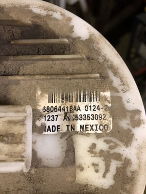

Hello, this is my first post here. I’m having issues locating the right fuel pump for my 2013 Ram 3500 5.7L hemi with a 52 gallon tank. The pump I pulled out was a part# 68064418AA. I can’t seem to find that exact part anywhere. Is there another part number that would be compatible with this tank/truck?
Thanks in advance!

Unfortunately I was unable to locate a number on the tank. But I did find a replacement pump!
68064418AC is a direct replacement for the 68064418AA.
I hope this information helps someone in the future.

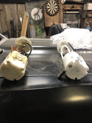

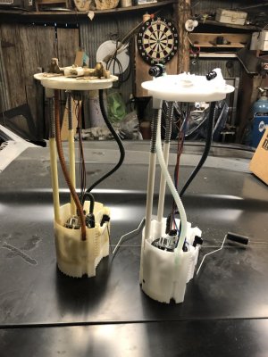

Heres a thought. can you rebuild the old pump using the new pump ? Im sure the fuel sending unit will not be the same, but the pump motors might.
S
Stephen M
Nov 12, 2019
8
Bell Buckle TN
5.7l hemi
You could but it would be tricky. The metal rods are pressed in the plastic passages for the top. I feel ether pulling or re pressing that metal rod would be difficult. The new pump is running great.
