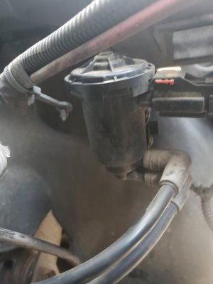

Just put my 06 5.7 back together. Theres a hose coming from the purge valve under the battery that connects somwhere. Who knows where and can help me. Valve is located under battery.
Can you take a picture? Could be front dif vent?Just put my 06 5.7 back together. Theres a hose coming from the purge valve under the battery that connects somwhere. Who knows where and can help me. Valve is located under battery.
two lines coming off evap purge slenoid,bottom one goes back to leak det.pump(under truck),top one goes to intake,right behind the line for the brake booster.
