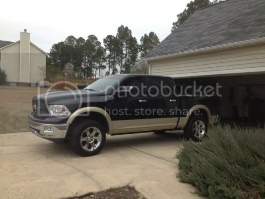

Looking to see if anyone has this setup up and if you can send pics. Bilsteins set at 2.8. 1 inch rear coil spacer. And a 1.5 inch body lift. Thanks

Are the top pictures the "before"?
