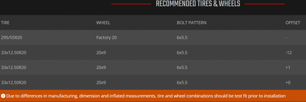

I've got a 2020 RAM 1500 Laramie 4x4 crew cab and it has the stock wheels (6 lug, 20") with stock 275/55/r20 tires. I also installed the Rough Country 2" leveling struts in the front. I'm going to be purchasing the Falken Wildpeak A/T3W.
My question is what size tires can I fit on the stock rims without rubbing? I'm including the screenshot from the Rough Country website, but I'm an idiot with this stuff and don't understand the conversion. I'm pretty sure I can run 275/60/r20, but can I run 285/60/r20 tires? What about 285/65/r20?

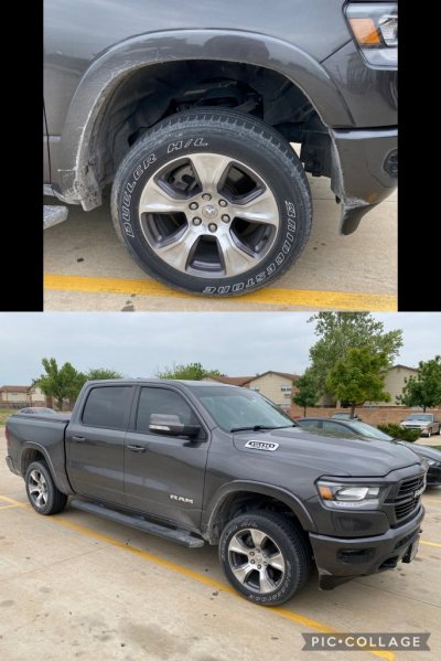

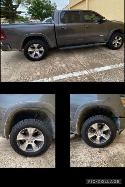

Replaced the original Bridgestone Dueler H/L at 275/55/r20 with Falken Wildpeak AT3/W at 295/60/r20. Ride is smoother, truck sits a little higher, and I couldn't be happier with the purchase.
