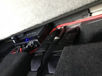

Well I got my sub box the other day from Paul at Net Audio. The box looks incredible. This is my first time installing a car audio system, and everything fell into place easily. The harness made life so simple, just tapped the rear signal into the LC2i along with the power and ground, ran a remote wire out from that into a Rockford Fosgate R500x1D, powering a RF Punch P2 2ohm DVC wired up to 4ohms. Sounds good hits decent. Makes me want more bass but it’s ok for now, here’s some pics. Thanks again Paul.

what harness did you use that you are talking about? also what did you do for your remote turn on?

netaudio makes an inline harness for adding a LOC without having to cut into factory wiring. A little pricey but very nice.

Net Audio makes a “OEM” harness with the head unit plugs so you don’t have to hack up the factor wiring. Ran the 12v and ground off that harness into the LCi2 and then ran the blue remote turn on wire from the out port of the LCi and into the remote on the amp. Worked like a charm.
