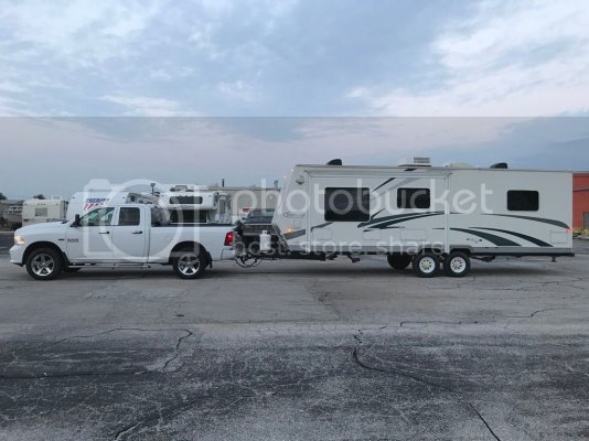

Nice rig. Congrats. But I'd double check your weights. What is your payload limit? What gear are you bringing? How many people in your truck?
Unless that side shot is deceptive by camera angle, double check your wdh set-up, as that rig looks nose high to me which you don't want pulling something that long and heavy with a half ton truck.

Nice rig. I'd try to get the trailer nosed-down just a bit. About as much below center as it appears to be above center currently.

Yeah I do see what youre saying the picture does make it look nose up. The level on the side of the rig shows it being nose down but maybe thats not a particularly accurate model? It did seem to pull pretty well but i'll probably put a level on the frame to double check.

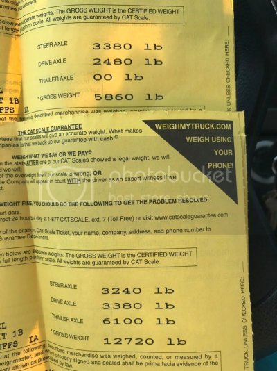

Update!
So my day started...awesome (not). Went to hook up the trailer to go get it weighed. Noticed a weird little black clip on a wire attached to the safety chain and a black box on the frame was unplugged so I put that back in and taped it in place temporarily, got all the stabilizers up, blocks put away, hooked it up and went to move and the thing didn't even budge... weird. Just installed the trailer brake controller so I'm thinking maybe I did something wrong. Checked the voltages all over, everything A-ok.. hmm. Unplug, plug back in, still nothing. Unplug and try, still no.. f*ck. So I go home, grab a bunch of tools, jacks, stands, etc and head back. Put all the blocks back out, stabilize the unit, jack up one side, get all the nuts loose and lubricate a few things. "Hmm I have some zip ties in here maybe I should zip tie that plug in real quick since the tape looks ghetto." Snug up the plug and I hear a click come from the unit and the monitor inside beeps at me... odd. Walk back over and go to remove a wheel to get at the brakes and its freaking spinning freely now. 45 minutes of my life in 90 degree weather could have been avoided by (2) 6" zip ties, awesome.
So my brake controller is a Draw-Tite 5535 Trailer Brake Control (I-Command Electronic - Proportional) and an adapter for my truck.. kinda. Basically there are 4 wires I had to find and tap into, install would be very easy if you know what you're looking for, and the cost was less than $70. If anyone has any questions about going this route let me know. I am satisfied with this controller and have the gain set at 6 with boost set at 1 (initial braking is 1.2/6 gain). I feel this is a solid compromise between not locking the tires up at low speed quick stops (25mph ish) and strong controlled braking at highway speeds.
Here are the weights I got today and the numbers I was going off of.
I found my GCVWR from a PDF put out by RAM, here's an example of what I found as a regular website but for a 2015 which was actually a couple hundred pounds higher: https://www.ramtrucks.com/assets/towing_guide/pdf/2015_ram_1500_towing_charts.pdf. So judging from the PDF my trucks GCVWR is either 14,150 or 15,650 depending on my rear axle gear ratio of either 3.55 or 3.92. I scoured the axle looking for this info to no avail, anyone know where to get this??
Judging from these numbers, if I'm reading them correctly, I have about 1,430#'s left for my GCVWR if its the lower 14,150 number. I have about 600#'s left for both of the GAWR. The tire ratings I'm not too worried about since my aftermarket tires are rated higher but if I compare rear axle weights I have about 500lbs of payload left.
So of the 1430#'s of GCVWR left the only stuff missing from these weights is ~160's of wife, any liquid in the campers' tanks (which will probably remain empty for traveling anyway), and clothes/camping gear. The camper already has a bunch of pots, pans, blankets, etc from the previous owners so the heavy stuff is already there. If my wife finds a way to pack about 1,200#'s of clothes i'll probably stay home anyway lol
Anyone have any insights on this? Something I'm missing or reading wrong? Rear axle gear ratio insight? I'm pretty pumped about these results so far, I honestly thought I'd be a little closer to overweight than this so I'm thrilled.

Your weights are looking pretty good and it sounds like you've done all the right things to tow near the upper limits (airbags, tires, etc.).
From the weights on the scale tag you should be fine with either axle ratio - but better to have the 3.92s for sure.
Keep in mind though the GCWR and axle thing is a separate thing entirely from the payload. The GCWR is how much the truck can pull. The payload is how much it can carry.
For a little contrast, I was out with a buddy this weekend with a 1500 Ram he just got. Great truck - Limited with all the bells and whistles. Problem is those are some heavy bells and whistles. I grabbed a peek at his door tag and his payload was 1089#. Full bed of firewood and supplies, 28' loaded up TT - he was probably close to double the payload. All he could tell me is the truck, "can tow 10,000#" and his trailer weighs 8000# :whymewhyme:
