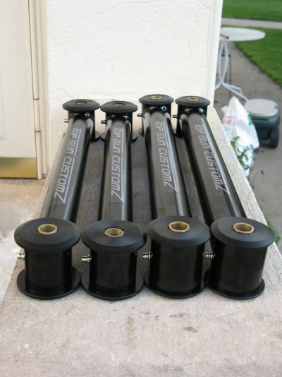

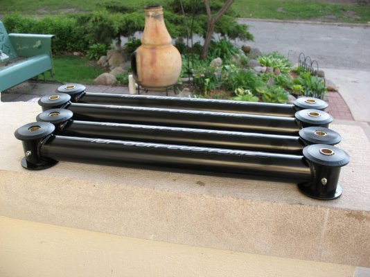

well guys, got my second 2 tires delivered yesterday (4/24) and i got my new Control Arms delivered today. So now all i gotta do is install new control arms and get truck aligned then get the new tires on my truck.
So anyway, heres just a few pics of the new Control Arms, their for a 00-02 Dodge Ram 2500/3500 with 2-3" of front lift
Anyone have any suggestions on how i should go about doing the install on these control arms?

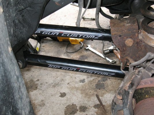

ive been fighting these mother ******* for 2 days now and STILL their not in! ive NEVER seen so much trouble gettingsomething out except for my ball joints and hubs 2 yrs ago. ive gone through AT LEAST 10 sawzall blades and finaly got the last of only 2 bolts cut! what a PITA!!!!!!!!!!!!!!!!

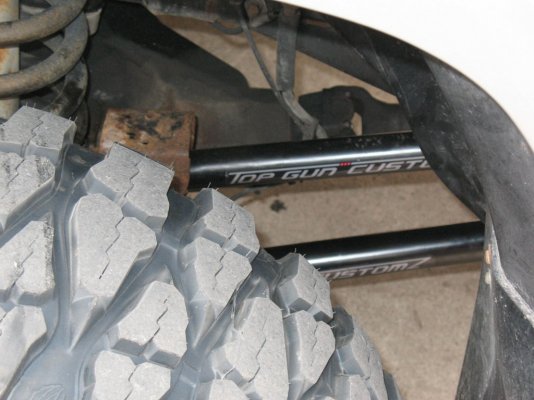

any installed pictures? I could see new CA's in my future if their worth the $200 or so...
