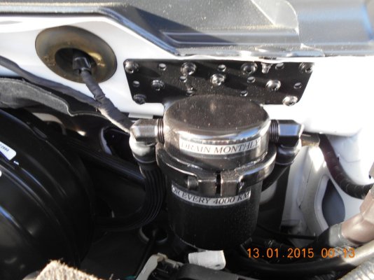

Back when i was playing with a 4.7 in my old 13,i put a catch can on it,and if any engine needed a catch can,it was that little 4.7,it put more sludge into the can then any Hemi i've ever owned

Here's my post from 10 years ago,on another forum,but you can easily adapt the Hemi can to the 4.7,instead of the Mod motor Ford can i used back then.The Moroso Hemi can has a bracket that lets you bolt it to the fender,or pretty well any place you want to bolt it to.
I have a Moroso can on my 4.7.
I like the Moroso can,as it has a valve that allows you to drain it.
I copied my buddy Audio1's idea of running a hose to the bottom of the frame,and adding an extra 1/4 turn ball valve.
The ball valve at the bottom prevents the hose from dripping on the garage floor
I used a Ford Mod motor can,as it had an easily modified bracket.
Mine bolts to the firewall by the brake booster.
The PCV line is on that side of the engine.
I cut and rewelded the bracket,and added a plate to it.
It wasn't hard to make it bolt to the firewall,but i did have to do some welding.
As far as i know,there isn't a 4.7 specific catch can,so you'll have to do some modding to make one work.
I'm a firm believer in them on 4.7's,i drain mine every thousand kilometers,and it's always got a couple ounces of oil in it
