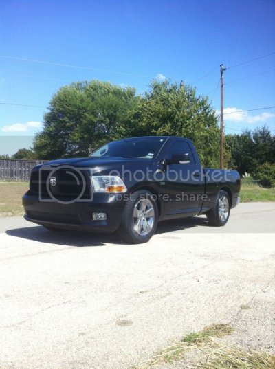

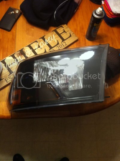

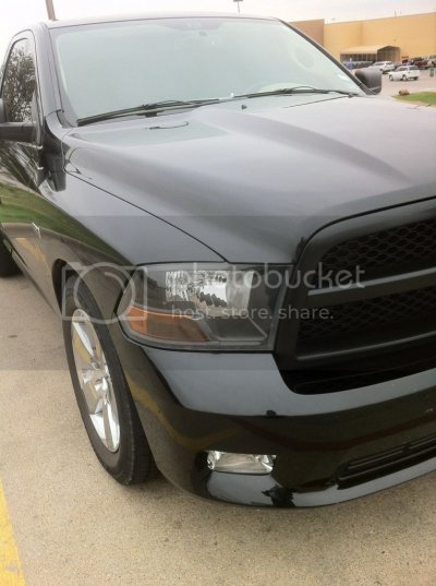

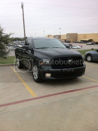

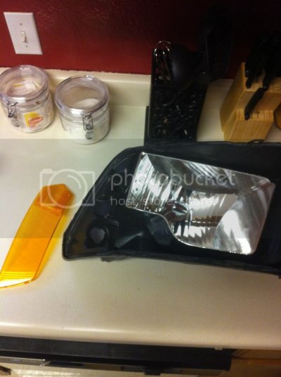

got bored yesterday and opened up my head lights. what do you guys think?

thanks fellas. i know i sent you a Pm about getting my lights done but my inner do it you selfer said well. if i screw them up i'll just buy some lol so i stuck mine off in the oven and prayed for the best! :crazy:

SOOOOOOO much better!
What did you use to tint the amber reflector?
Any words of advice on opening the lights up?

^^ looks like he just painted the inside where the amber reflector is and then put the amber back on? could be wrong though

thats excatly what i did. 250 for 10 min and slowly pry apart the lens. work the corners first!
