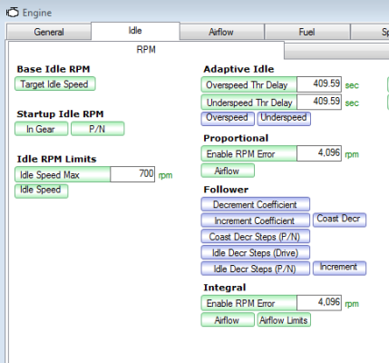

2014 is fairly straightforward as your ECU is not locked like 2015 and up. So it would be HPTuner obd dongle ($400), free software download, ecu/tcu credits ($50 each, 2 credits for ecu, 4 credits if you have the 8 speed), and go from there. Either you can learn to edit the files yourself, or pay for tuning (worth it IMO) and ask as part of the tuning to raise the idle speed.
