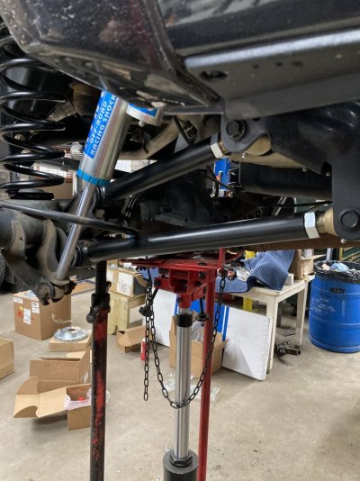

I’m working on being a rebuild station not that helps you know. The idea is to rebuild fox, king and icon but still in the early stages
That’s awesome! It will be a while before I need to do mine, but I definitely know where I’ll be bringing my truck when it’s time.
Put those Kings away show off!!!!
Joking aside im thinking some icon 2.5 rears might be in order since I can Get them fixxed up now.
Those pic’s are from Quick_Shifter’s shop & work done by him, the only mechanic I trust with my truck
