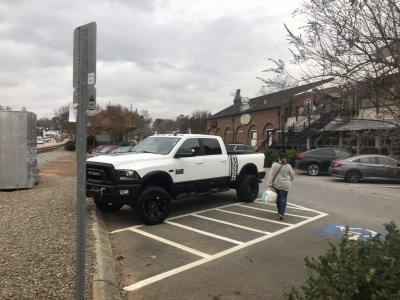

Just got a 2018..power wagon
Need some input for mods..
I want to put a front camera maybe side cameras and utilize the touchscreen to view it to any members know what I need...
Led bar in front grill,rather not a bull bar
Are led bulbs worth the investment,was looking at the gtr gen2...
Aev rocker pod is on order for center of dash...
What’s best tuner,if one is available or should I just get the calibration tuner for speed..
Truck came with 35x12.5x20 rims , I have a feeling the backspacing is wrong at full-turnthey rub

First off welcome to the club! Judging by those pics it looks like those wheels poke out quite a bit. If your looking for new wheels a +18 to +27 is the sweet spot for power wagons especially if you wanna throw 37s on youll get by with very minimal trimming with those offsets.

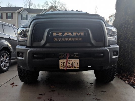

I did a 20" light bar behind my grill. Basically just used a piece of 1" wide 1/8" flat bar and bridged it across 2 points on the back of the grill and mounted my light to it. The first pic i used is someone elses grill and they used angle but you get the idea
