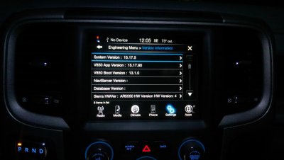

I think the problem is that you are using a 2015 radio in a 2014 vehicle. What software is the radio running?
A
alex_5_7
Dec 13, 2013
178
114

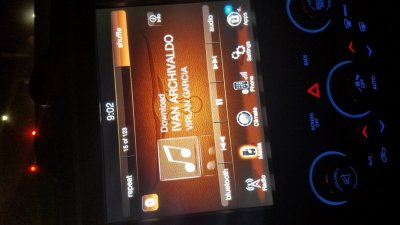

Do you have the bluetooth/aux/usb showing on the left side when you the have media tab selected?
Sent from my HTC One_M8 using Tapatalk
Nope :( and the usb and auxiliary light up and everything. I just don't get the option to show up on the media screen.

Apparently the radio I purchased came from a jeep grand cherokee limited 2015 and my truck is a 2014 express. Does this have anything to do?
SitKneelBend
Moderator
Member Relations Specialist
Jan 8, 2015
10,930
7,584
St. Louis
3.6 Pentastar
Yes the drivers are different for the USB reader. It is fixable via firmware flash, but typically it is not advisable to flash firmware for RAMs on Jeep radios.
That being said, the correct drivers for the reader will be in the RAM download for a 2015. Flashing this firmware could result in a bricked radio. As another member said its advisable not to use 2015 radios in 13-14 trucks, but "some" have had success.
If you wish to avoid the risk, you can bypass the USB reader and plug a long USB extension cable directly into the back of the radio (gray plug) and put the other end in your glove box.
