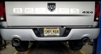

Go with magnaflow catback with 5 inch tips the 5 inch tips look so much better than the factory 4 inch tips magnaflow sounds awesome and will last a long time
