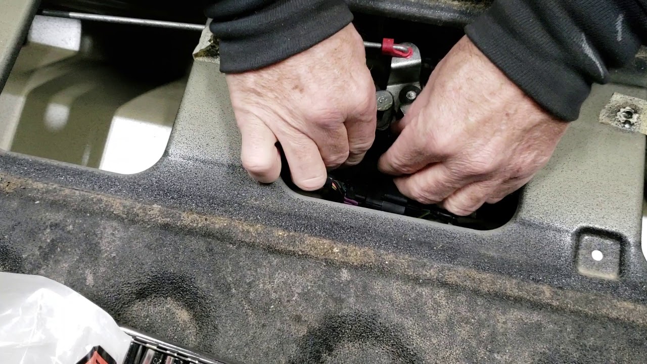

You can just unplug the power lock actuator in the tailgate so that it doesn't lock on your current handle assembly.
There was a recall on the tailgate handle that addressed the problem of the tailgate opening due power lock overdriving the latch.

There is a recall to fix this. Take it to your dealer for a free fix or buy the rubber insert to install it yourself.

They extended it to 14s. I said the same thing when I found the recall. If you want to fix it yourself its very easy. I fixed it myself and then the dealership did a fix on top of the fix even though I told them I already performed the recall and not to touch it (I always back in and a randomly falling tailgate is an insurance claim waiting to happen)...if you're interested in doing it yourself I'll dig up the part number. The dealers spacer is the one next to mine (there should only be one, they broke it in a whole new way).

I have a 14 also ,the part to fix this costs under 5 dollars. Takes about ten minutes to fix yourself. No need to buy a new handle ,just the little piece of rubber to fix it.
