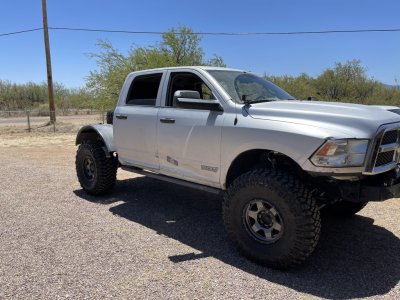

New tranny already.. need to regear for 37’s.
Steven Barnes
Jun 26, 2018
Cherry Valley
2018 Pw, 63 k miles, 40 k on 37’s.
95% daily driver. New transmission installed. Glad I got the Lifetime warranty.
I am learning that regearing will get more life out of the transmission.
What ratio should I go to? I’m going to keep running 37’s.

37 compared to 33‘s or about 20% larger. So I imagine I’ve got a gear down about 20%.
is this sound thinking. So 20% lower gear than 410s
410x 20%=82
410 + 82 = 492
so 488 or the next numerically higher option should get me close to factory,
next question.. what vendor is most reputable and makes ring n pinion gears for my truck?

I have the math!
Formula: (gear ratio)÷(tire size) = (gear ratio)÷(tire size) solve for unknown gear ratio
(4.10)/(33)x(37)=4.596
The actual ratio will depend on what manufacturers make. A higher number will be great for around town driving and off road for the extra torque but will kill mpg at highway speeds.
I have not driven an 6 speed PW with 33s vs 37s so I don't know how if feels to dive. That is barely enough of a difference for the truck to care. All you have done is lower your effective gear ratio 3.66 on 33s. The other stock gear ratio for ram is 3.73. There is no way that 37s did your transmission in.
You need to do what you think is right and will give you peace of mind. At the end of the day, that is all that matters.

33" vs. 37" tires are around a 12% difference in circumference (or how far the truck will move with each rotation of the tire). As stated above on paper a 4.59 is the gearing number to make up for ONLY that difference, and obviously 4.56 is the closest that is available. However, and already stated, it does not make up for the increase weight and rolling resistance of the larger tires....and the simple fact it's very hard to tell the difference between something like 4.10 vs. 4.56 in real life. I would recommend at least 4.88 or even 5.13.
But also as said above, I don't think that 37" tires was the biggest issue with the trans only lasting 63k miles. You are talking about the same powertrain setup used on trucks with 3.73 gears and rated to tow upwards of 14k lbs. which put a lot more stress on it than 37's. I do think a big part of it is recalibrating the ECU for the tires though.

Can't go wrong with Yukon or the OE, AAM (may not have the ratio though). Need to do front too. Easy to FU and if you're if not comfortable doing it, need to find a reputable axle shop that can do it right. If it's not right than you'll have to do all over again, assuming the R&P isn't destroyed. Yukon has an excellent master install kit. Figure $2500-3000K parts and labor if farmed out, conservatively.
