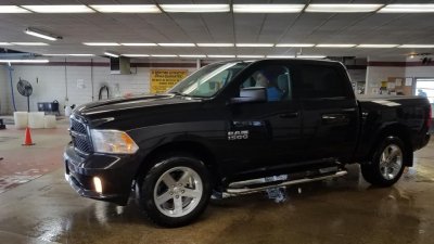

I'm shopping for wheels and tires for my 2015 Ram 1500 Express. I'm going for a street look.
Right now I've selected a set of 22-inch wheels, 10 inches deep. I have a set of tires picked out, 275/45 R22. My truck is a 4x4 and the suspension is stock.
Anything I need to watch out for? Will a set like this work out of the gate or will there be some work necessary to avoid rubbing? Anybody have pictures of your Ram with a similar config?

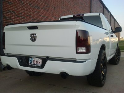

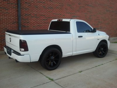

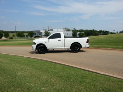

Not a 4 door, but I did 22" KMC Slides on my 2011. Lowered rear 2", and they drove great, 305/45/22

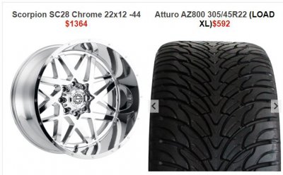

Your suggestions and another thread sent me down a whole nutha hour-long rabbit hole. Now I'm looking at 22x12 wheels, -44 offset, with 305/45 R22s. I saw photos of another truck with these exact wheel/tire dimensions and they looked great. My only concern now is rub, but with stock suspension, I think I'm good. Thoughts?

I had zero rub, I will check, I think 22x10's....been awhile. But let me check KMC slides backspacing
Graygoose
Indecisive Car Owner
Nov 21, 2011
16,824
31,526
Oklahoma
Convert, for now.
small
22x9.5 with +15mm and +38mm, I think I had 38's?

I was super thrown off by this chart, which is why I was looking at 275s for a 10 inch wheel as posed in my original question. Now I realize that chart is waaayy off...
