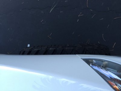

True statement^ anyways this is a picture of 0mm offset and a 12.50" wide wheel (as far as sticking out)
