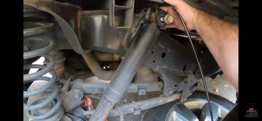

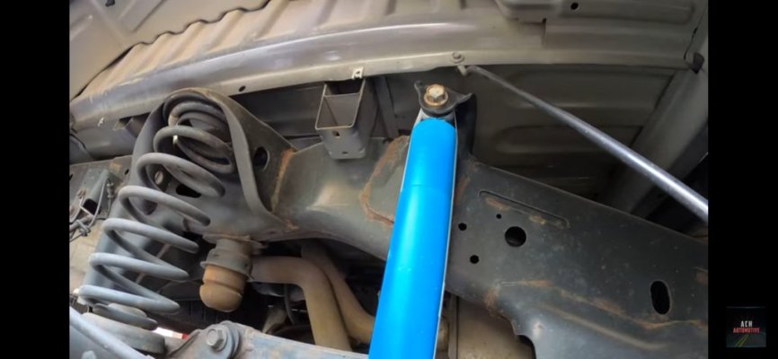

Assuming you completely pulled off the inner wheelwells, or at least pulled back part of them, when installing the shocks. Are you sure when re-installing them they didn't get tweaked out some and are fully seated back in? As stated above it's definitely worth while seeing if the shock bolt is pushing out on the liner also. The only thing that makes sense is that the wheelwell liners are not sitting in the same place as before and sticking out some.

The normal installation configuration is the bolt being inserted from the outside of the mount, with the nut on the inside of the mount. The bolt face is facing the wheel well liner and the nut is what you would grab with a crowsfoot, or wrench if you can get in there. If you reverse that, you have the additional threaded portion of the bolt sticking out and pushing on the wheel well liner. Again, not sure if that's your issue, but throwing it out there...for a reason.
OK, I will reverse the orientation after work today. Hopefully it is just a combination of that mixed with the new suspension components that is causing the issue

OP, Definitely go check what he's saying quoted above.
Like he said, if rhe shock bolt is real long it may be pushing the plastic splash shield out into the path of the tire.
So far this makes the most sense.
I will reverse the orientation of the upper shock bolt after work today
I didn't remove the liners I just did the swap from under the truck. But I agree, the liners have to have moved somehow, maybe through a combination of new suspension components and the bolt/nut needing to have the direction reversed
