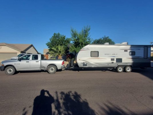

Here's how the truck looks hooked up to my travel trailer. This is from before I switched out the shocks and rear suspension components though. Doesn't seem to sag too much to me but I welcome feedback as this is my first travel trailer. Also, ignore the huge dent from getting high centered on a boulder

Ok, I see the weight now. On mine there is plenty of distance between the inner tire and the wheel house. Are your wheels close on both sides? Or just one side. Sorry if you've already answered that...I didn't go back and re-read all the posts again.
I wonder if the steel wheels are narrower?? (mine are Aluminum)..

My tires are fairly close to the wheel well liners, I think that is what you are asking. I can maybe fit two fingers between the tire and the liner. If that is not what you are asking let me know
