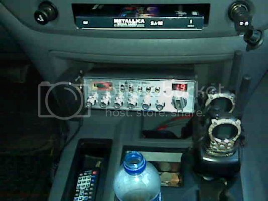

here's my setup
i run a mini wilson under the rear bumper along w/ my scanner antenna

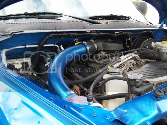

The Spectre won't pull any cooler air than the 14x3. I have a Scangauge2 that displays Intake Air Temps using the IAT sensor. The dinky heat shield it comes with does nothing in the way of heat protection, not to mention the aluminum tube of the spectre will get so hot you can't even touch it with your hand. The best bang for the buck is definitely the 14x3 with a k&n. However, if you want a nice CAI setup look into the S&B or Volant. To me, the S&B is the best because it flows just as much as the 14x3, but with the same temps as the stocker. It is about a 40 degree difference at idle, once you get moving the 14x3 is only 10 to 15 degrees hotter than a REAL cold air intake.
With all that said, there really isn't a ton of difference between any of the intakes, including the stocker with a k&n drop in.
