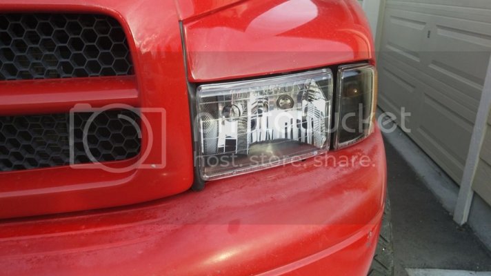

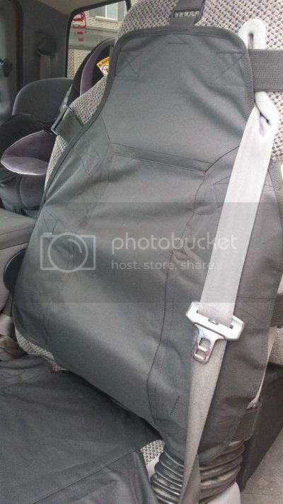

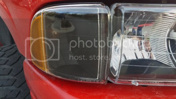

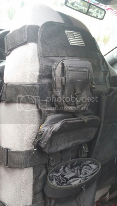

Was going to work on the bumper tonight but decided to save that for another night. Instead, went ahead and installed the other headlights and a seat cover.

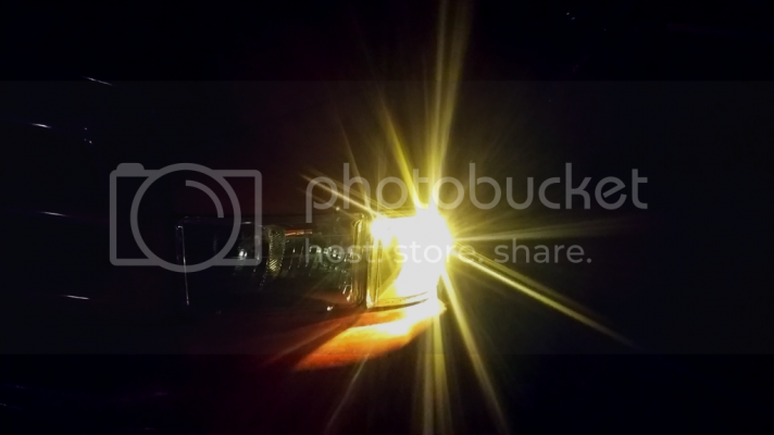

Headlights I'm frustrated with again. Never noticed there's nothing reflective in the back of the signal housing. Park and turn are pure bulb, so i ordered some led bulbs to see if They help. Also, my xenon were again screwing up so i threw the damn halogen bulbs back in for the time being. Ordered in the xkglow 76w kit. Hoping the red housings of the bulbs reflect back so during the day when the Headlights are off will have a red tint.

What's the beam quality on those Anzo Black Sport housings?

The ones pictured above or the old ones i just replaced today?

If you're referring to the sport housings, so far I love them. Even with halogen bulbs that are in it now it's the brightest I've had since buying the truck.
The Anzo knock off's that were in before with the LED bars across the bottom weren't my taste, and IMO need something more than a halogen bulb to power them. They're more pencil beamed than these sport housings are, and halogens just don't quite have enough output to thrown the light down the road.
I purchased a xenon kit to install with them originally when I bought the housings, but with my truck having quad headlights I couldn't get them to function properly in the single bulb housings. Thus the reason I purchased the Spyder sport headlights, though it seems the kit I ordered is not designed for quad headlights, only single headlights as what the 9007's are actually made for. Thus why I just purchased the LED kit from XKGlow. I inquired about them a few days ago last week and they confirmed that I'll just ground the high-beam connector rather than hook it into the ballast, giving me low beam from the LED's then I'll pick up some silver stars or something for the high-beams.

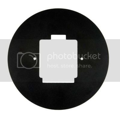

Side note, I ordered a few more things for the truck. Ordered in a Flowmaster 44 series and a black 3.5" MBRP tip. Picking it up from the muffler shop tonight after work. 40 series just isn't quite enough for my anymore, so going to open her up with more sound. Also decided to finally stop messing around with adding fog lights, flush mounts, blah blah blah. Broke down and ordered in the Rigid Dually SAE Fog lights. Also ordered in the adapters for the 12-14 GMC Sierra, basically some round plates that the Dually will fit in and hopefully fill the caps from the holes in the bumper. These are them.

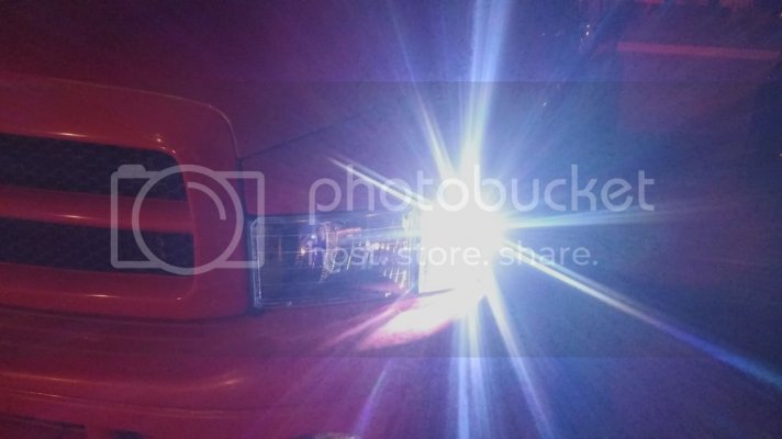

Switchback LED's and EP27 flasher relay installed tonight. Way better than the halogen bulbs. Need to get the LED headlight bulbs in ASAP as now my headlights are different than the signals and stick out like a sore thumb.

XKGlow kit installed. One of my favorite upgrades thus far.

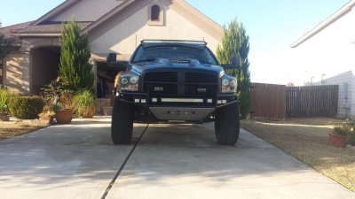

Well here is all the different sizes I have in my front bumper. The key is to keep it balanced on each side. I use the two on each side on the outside of the bumper as fog lights, I just have them angled down more. Also a pic of the rear lights.

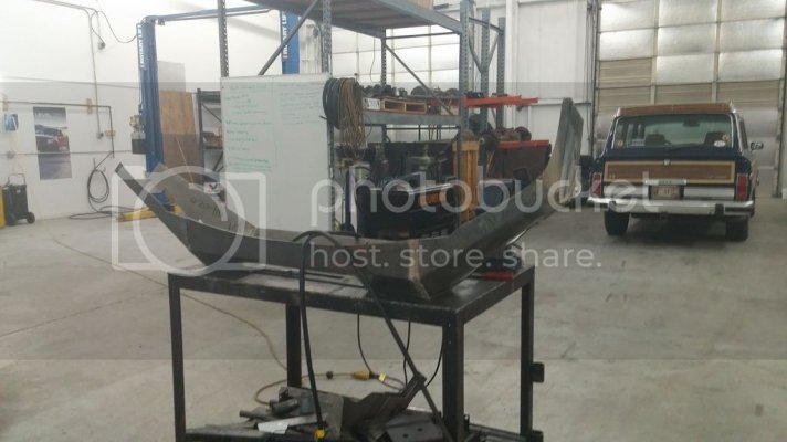

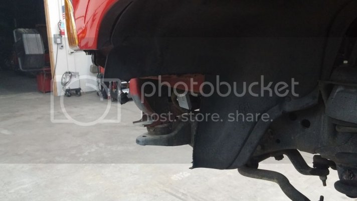

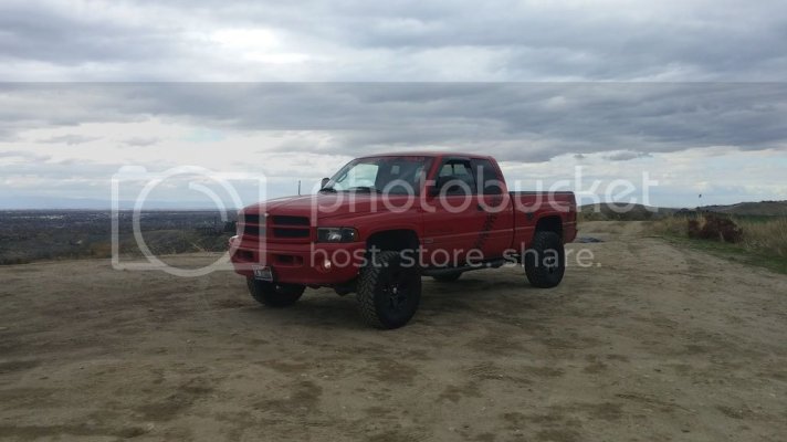

Alright. Got a ton done today, but I'm still a ways out. It appears I will have to do a large amount of trimming to clear the grille, after getting it fit on the truck and finding that out I called it a day at midnight. But progress!
Bumper
Goodies!
Up up up
And it's off!
Trimmed!
Test fit for dimensions. It's square! Flush on both sides.
Heading home.
