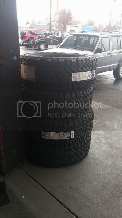

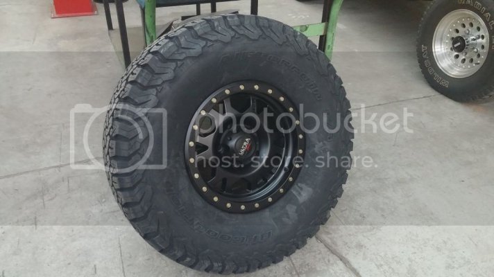

Talked to the wife tonight. Got the go ahead for the 16" Ultra 102's. Tomorrow I'll check on tire prices and see if I can find any better deals, if not I'll be snatching the KO2's

Talked to a couple different reps this morning regarding tires, nobody can beat the price of the KO2's. So I went ahead and got the ball rolling for them to come in, also ordered in the Ultra 102's in a satin black finish. Pretty excited for the new shoes.

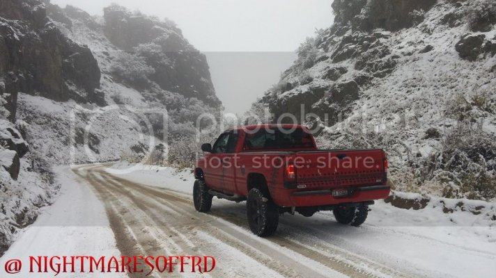

We've had snow in the mountains for about 3 weeks now, but we finally got some snow to fall in the valley today. Rained all night last night, then for whatever reason it started snowing around 8 this morning. Ground was wet, so I never thought it would stick, but within the past 2 hours we went from wet and cold to not seeing grass and accidents throughout the city. Pretty excited ha.

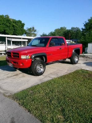

Nice truck lots of stuff added looks great!!!! My 01 sport.

Actually they're extremely wide to tell you the truth. They're Nitto's 315/70R17 which measure out to almost 35" tall and 13.25" wide. Definitely not narrow, the snow might just make them look deceiving.

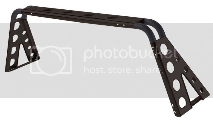

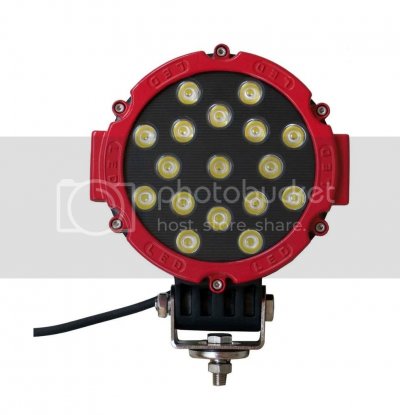

On his truck, it's not the same brand, but he's got the identical hood to the amerihood I've been looking at for a while, seeing it in person confirms that the hood will be coming shortly. I've also been bouncing back and forth between the Fab Fours headache rack and the Go Rhino Lightning Series bar, but was afraid of what the lightning bar will look like because it's made for the 3rd gen and up. Seeing it on his truck makes it clear that I want to use Go Rhino rather than Fab Fours, also save myself about 600 hundred bucks seeing as the headache rack will cost me around 1000 by the time I have it with the modifiers.
Here's what it looks like.
I'm thinking I'll install it black then photoshop it red and see what it looks like. I want to avoid doing any light bars on top of the truck all together, so if any lights go on top of the Lightning Bar then it'll be 4 of these.

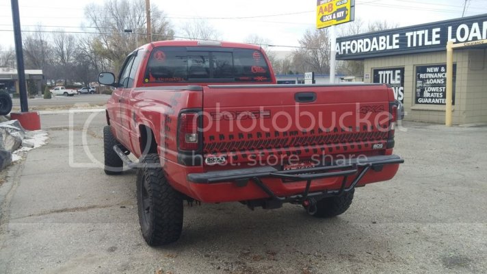

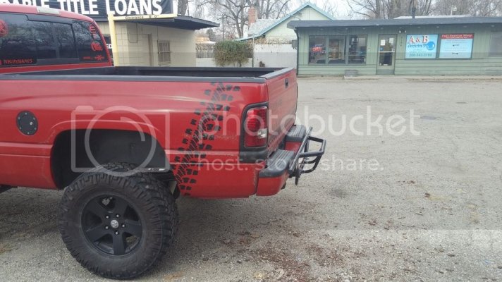

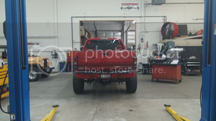

Rear Runner installed this morning before work. License plate relocated after work, too dark for me to grab pics of that though.
Had a doctors appointment today with the wife, first time driving the truck into a parking garage with the lift. Found out the lightning bar is actually a no go. I've only got about 4" above the truck before it hits, and the wife works at the hospital the parking garage is at. Needless to say if by chance the truck gets driven to her work by her, I don't want to get that phone call.
Photo chopped the fab fours headache rack in. Leaving it black, it ties in well enough that I'm not going to bother putting more work into going red.

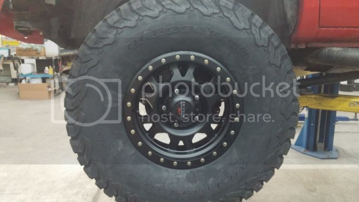

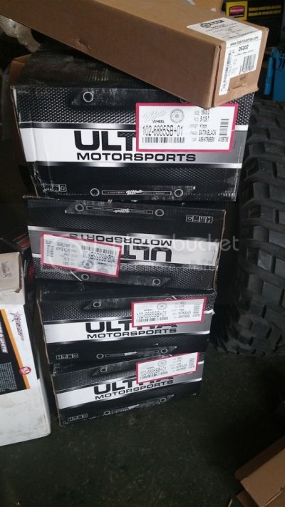

1) Wheels showed today. Gonna get them mounted and balance today, then slap them on tonight.
Wheels
Tires that have been here since Tuesday

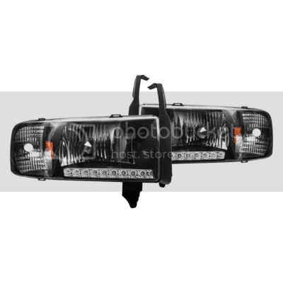

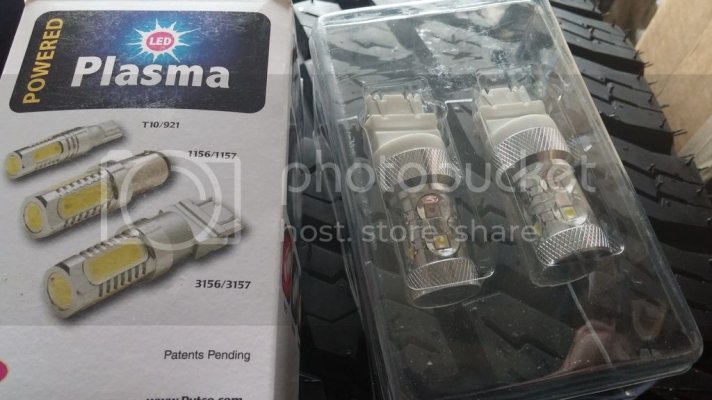

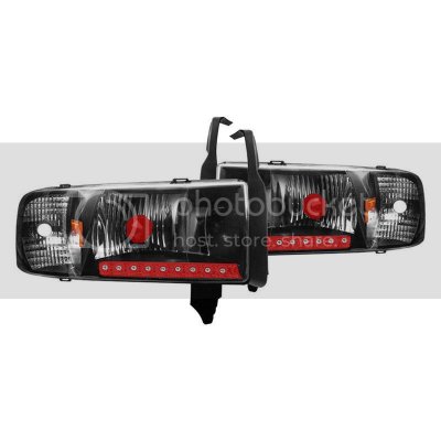

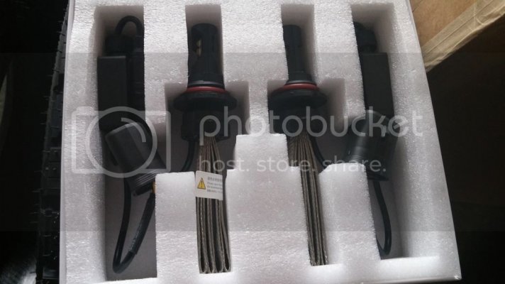

2) New LED headlight bulbs and switchback 3157's. I've been fighting with bulbs since first installing the Spyder headlight housings. The signal housing have nothing reflective inside, and 3 different bulbs haven't worked for me. So, I've decided to take the Winjet headlights I've had sitting and do a little "customization" to them, along with throwing some different stuff in.
Here's the plan for the headlights
Currently how they are
Here's a quick mock of what I'm doing
One of my distributors was having a sale on Putco products, and I had sold a set of the Cree bulbs after a customer saw the headlights on my truck. When I went to order them, I found that there was a massive end of year sale going on and they were trying to clear Putco off the shelves. So, I got a pair of the Nite-lux bulbs that are black housing with the ribbons off the back rather than the electric fans, and a set of the 3157 switchback bulbs for dirt cheap.
9007 bulbs
Switchbacks
Also coming in today is my 3" block KIT from BDS that's specific for the Ram 1500's, so tonight I'll be throwing the wheels and tires on, along with the rear blocks to finally level this sumbitch.
Then tonight after everyone falls asleep, I'll sneak out to the kitchen table and pull apart the headlights and start masking everything off. Gotta grab some butyl tape tonight to reseal them, but I've already got the red paint left over from doing the bumper so should look ******* when it's all done.

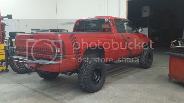

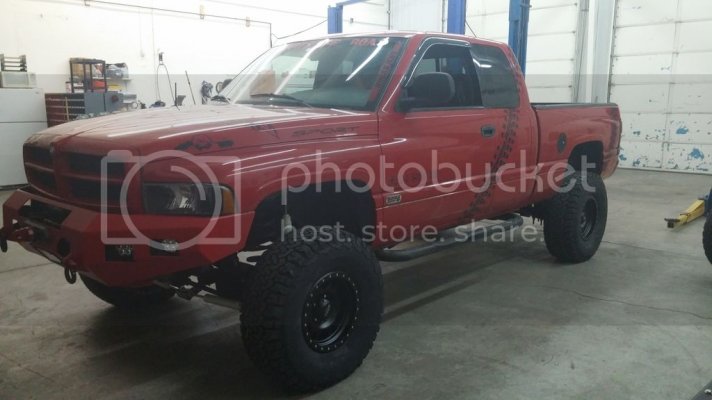

Wheels, tires, and 3" rear installed! Didn't even get the 2" spacers off, impact wouldn't budge them, good to know the red locktite works! I'll get them off eventually, for now it looks good and IT'S FINALLY LEVEL!

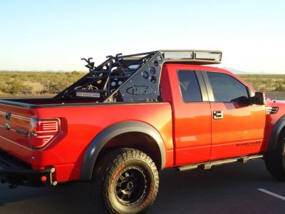

I've been thinking of one of these... I saw one on a Silverado last week and liked it.
