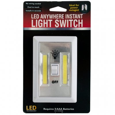

These put out far better light than our factory map lights and most include Velcro for attaching to the headliner. ;)
