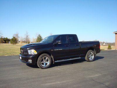

33x12.50x20 federal mt on stock wheels painted black with 1/4 RCX spacers on the front.

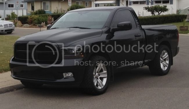

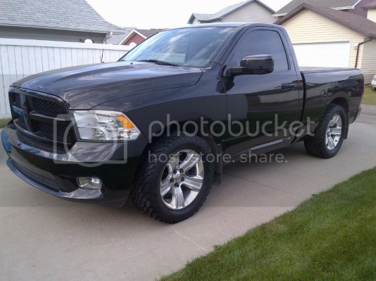

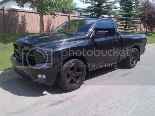

2010
305/50R20 General Grabber AT2's 32" x 12.4"
Stock 14' Sport Alum wheels (20" x 9") +19 offset
10' RCSB 4x4 Sport with 2/3 Ground Force Drop
no spacers, no rubbin

Nice Truck. I notice a cover on your bed. What brand might that be?
Completely stock suspension? The RCX Spacers, those are for offset, right? Or is that for leveling? (Sorry I'm a noob)

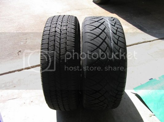

I have a 2011, will these tires fit my stock rims? Need new tires . Getting new wheels eventually...
Yup, the old Sport Wheels are the same offset/size
I ran 305/50R20 Nitto Terra Grapplers on my last set
At 32" tall they really look better on a lowered truck though
....never been a problem for me....and we get LOTS of snow
Yes, stock suspension. The spacers stick the wheels further out my .25mm this allows the tire to move away from the upper control arm.

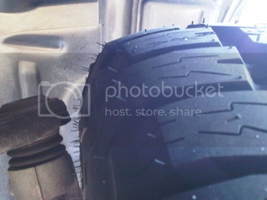

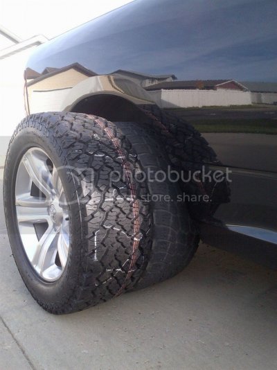

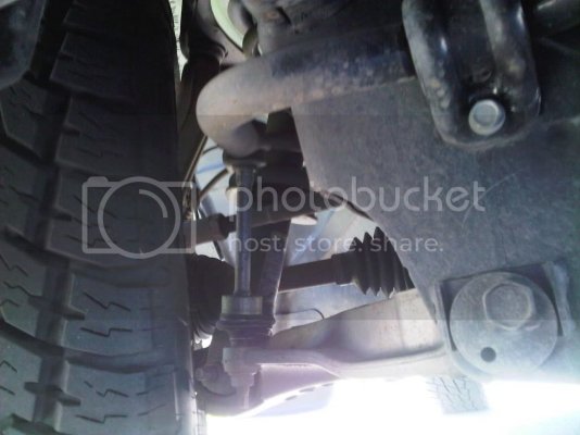

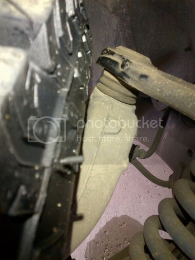

Upper control arm clearance with 12.2" wide tire on stock sport wheel (Terra Grappler)
Front sway bar clearance at full steering lock (passenger side , left turn)
Control Arm clearance is a little tighter with the new General Grabbers at 12.4" wide..
Not ALL 305 or 12.5" tires measure the same
Check with the manufacturers mounted measurements charts
Some are 11.6" wide, some are 13.6" wide
which may explain why "some" get rubbing and some do not. :favorites13:

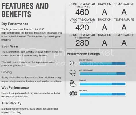

What would be a good street looking tire in this size? Looking to keep the street look vs the off-road look.
Nitto 420s 305/50R20
(no good in snow though)
I plan to get a set of those for Summer,
as soon as I find another set of 14' sport wheels for $600 that will be powdercoated gloss black

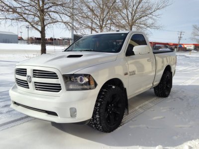

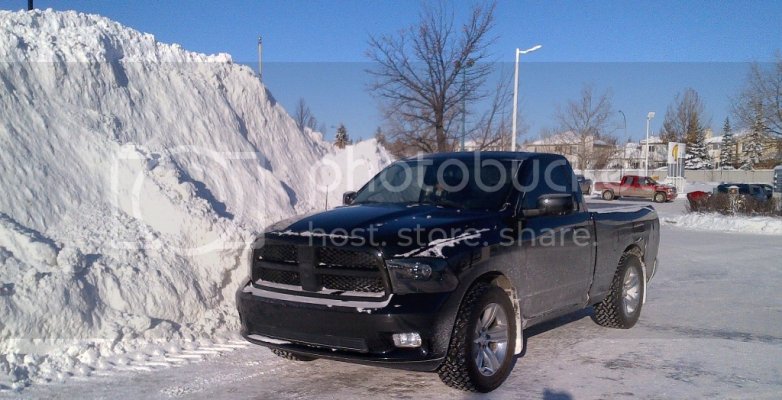

Stock 275/60R20 vs 305/50R20 420s
