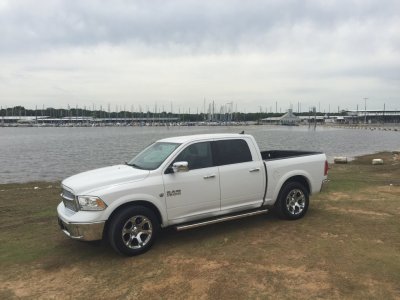

RAM noob here, but a car guy for a long time....
I just picked up my 2018 RAM 1500 Laramie with FWD. I'd like to put a 2-3 "little" lift kit on the truck however I don't want to sacrifice any driveability, warranties, mechanical....etc. Simply, I'd like to raise the truck for aesthetics as I really don't plan on taking it off road. I'm going to leave the OEM tire and wheels on the truck.
I live in the Dallas/Ft Worth area and would like a solid shop to do the work.
Any recommendations on kits and or installation companies? I checked with Grapevine Dodge and they wanted 3k for a 2" OEM kit.... that seemed super expensive.
BTW.... Here are my other toys; 2004 Corvette Z06 Commemorative and a 1991 Corvette ZR1. Both pretty rare cars.
Thanks for your help!

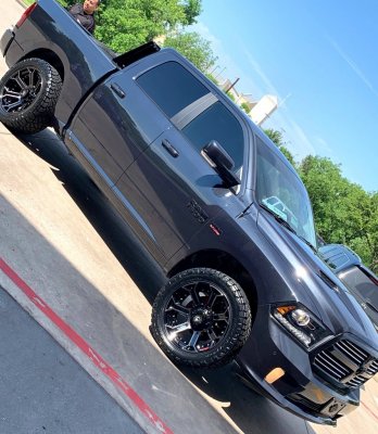

Leveling kit and rear spacer is all you need. I installed bilstein 5100 front leveling struts set to 2” and no rear spacer. I’m almost perfectly level. They go up to 2.8” and then just install rear spacers if you want. I’m on stock size tires
damn...thats my truck tomorrow after i get Billy's installed at 2.1! looking good reaffirms this bundle of money i'm spending for a look. lol
