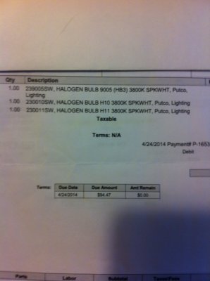

Sorry about the slow reply, got busy here with work. I found my old invoice for the Putco bulbs. I'm not sure which one you will need for your truck but here are the part numbers.
