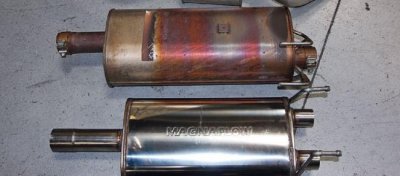

This is a picture of the stock muffler single in single out next to what I believe is a 18" Magnaflow single in double out.
As you can see the stock muffler is a beast. You obviously replaced an after market 14" with another after market 14".

Here is a picture of the 14, 18 and 24" Mufflex kits; a Magnaflow muffler already made up with the adapter piping in stainless to match the factory muffler install for bolt on applications.
You can see from end to end of the piping just how large the OEM box is.
