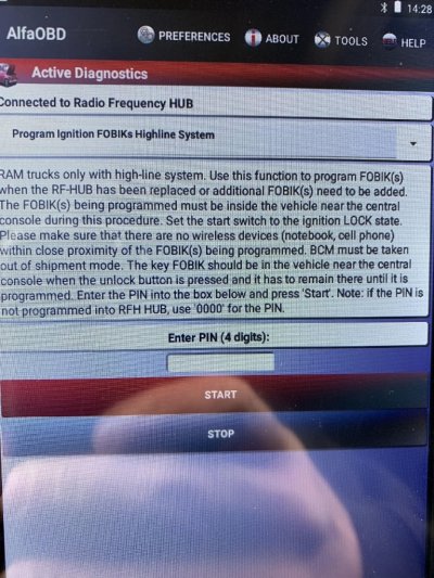

Does the hub talk and/or write the fobik information back to the ECU? Reason for asking is I ran into a thread on a german forum where they program the new remotes first (different Chrysler vehicle where they upgraded to push button), then swap the hub and perform the reset/replace procedure and it worked for them.

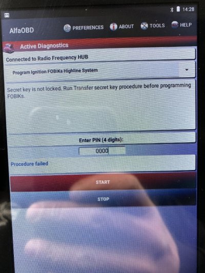

The way it’s worded has me thinking it should be a setting in the alfa, but either can’t find it, or he didn’t add it?
We can’t do anything with the RF Hub until that fob is programmed, and we can’t program the fob until the PCM and new hub “shake hands”. XQHcE8f.jpg

EDIT: BTW the whole "transfer secret key" process seems to be part of the PCM, not the BCM or RF hub. I cant find it anywhere in AlfaOBD, though. It looks like we need to run it to get the VIN into the new hub. There is a function called VIN Write in the Engine computer section of Alfa....I wonder if its the same thing?
I saw that and tried. Problem is, in order to connect to the Engine, the ignition needs to be in run position (MAR), but with the new hub connected that’s not possible.

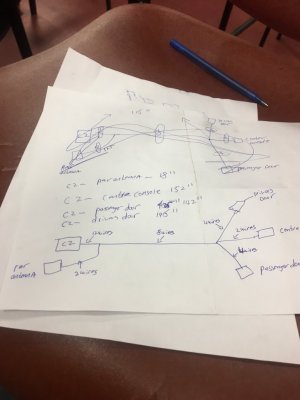

So you can either do this with cable or make a harness like mine .
I think using cables will be easier to keep track of things when building your harness .
If using cable the measurements for each run are as follow :
Everything is in inches
C2 to rear antenna 18 inches 2 wires
C2 to drivers door 196 (4 wires )
C2 to passenger door 142 (4 wires )
C2 to Centre Console 152 (2 wires )
If building harness refer to the pic
Same lengths but you would split the hanress into three sub harnesses at around 116 inches down from c2 connector .
I ran my wires down the passenger side and then to Centre console and then to drivers side .

I’m at my sons swim lessons so just drew this up quick so sorry for the mess but thought I Would try and give you something atleast
