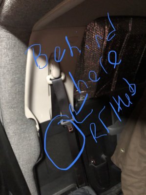

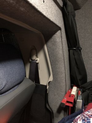

Ok question or two .... I have my17 c&c that's been up fitted so I don't have a back wall. It's all opened up for a sleeper unit. My rfhub is currently in the pillar post behind me. Now can I just place the keyless go antennas there as well. One behind me and the other behind the passenger seat. For that matter the antennas for the doors too being it's so close to the door handles anyways.
Secondly can you post part#'s again and where I can get the connectors for the antenna and one to the rfhub. Also post pics of the connectors at the rfhub.
Thirdly. Do all four antenna connections terminate at the same connector on the rfhub or is there two separate connectors. One for the inside antennas and the other to the doors.
And can I get these connectors at the dealer and what gauge wire did ya use? 16g or 18g or even 22g
Thank you

I used 20 awg wire .
The antenna connectors are in the first couple of pages of this thread .
Jimmy posted the connector required for rf hub c2.
I bought my connectors etc from mouser .
You can buy a c2 repair kit from the dealer and it will have the connector and the pins crimped already usually on like a 6 inch wire lead for the rf hub.
All the antennas and door handles get wired into c2 connector.
One 20 pin connector but only 12 slots used
