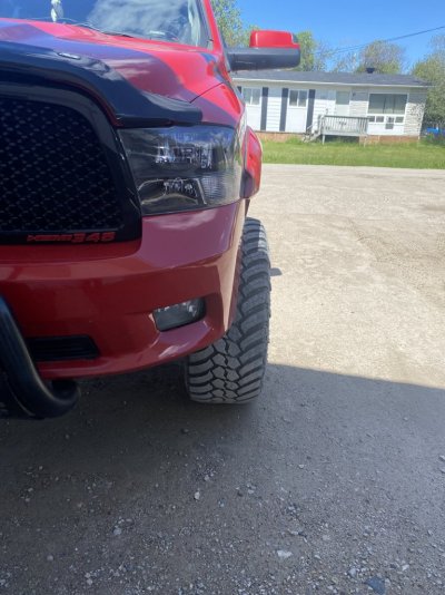

I was sitting here in my shed looking at my 2” Supreme Suspension wheel spacers I run with my 35/12.50/24 tires. I run 37/13.50/20 with a -51 offset rim currently. I switch them out when I get bored with the tires/rim.
My question (haven’t done this yet) what issues/if any, would I have running my 2” spacers with my -51 offset rim/tires? Truck has 9”s of lift.
