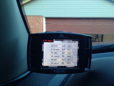

Streets are wet so my tires break loose at 50 mph , hopefully things dry out tomorrow and I can run my performance test on my BD. Last week I posted a 14:76 1/4 mile so I should do better than that.

Base line
Only had a Voilant fast fit and stock TB. It was about 20 F . Tomorrow will be mid 40 f with the Vararam and Moe's 87mm TB.
