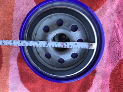

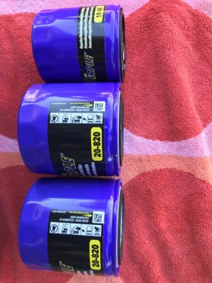

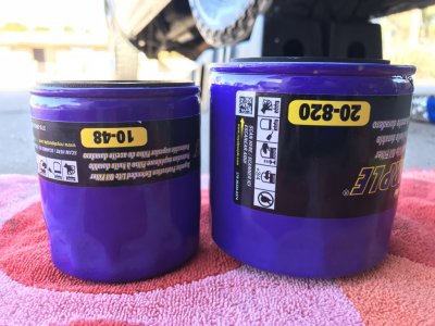

So for anyone still interested, I tried installing a brand new RP 20-820 again on my 2016 5.7 using RLK’s suggestion of using some Scotch Brite on the gasket seat surface and had no issues with leaking at all. I really believe there was a problem with the gasket on the first one I tried, but the extra cleaning with the Scotch Brite certainly couldn’t hurt... I noticed that from gasket to gasket on these filters that they can vary in thickness and consistency of thickness across the gasket, maybe something to pay attention to when installing a 20-820 on a newer truck?? Anyway I found that the difference in outside diameter on the larger filter vs the smaller one is only a sixteenth of an inch....

Glad it worked out for ya sir !!

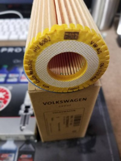

Nope. They recommend 10k OCIs. This is supposedly the best filter they make. Purchased from local dealer. Boxed as VW brand, Mann HU6002 printed on filter. Made in Czech. It looks and feels fairly solid, but it is cellulose for sure. The ends seem to be a denser cellulose and are somehow bonded. No plastic or metal.a622dc37acc3867ac6bbc1589de5f1e4.jpg

Oh I definitely will not. Probably closer to 3 or 4k if I cannot find a synthetic filter.
