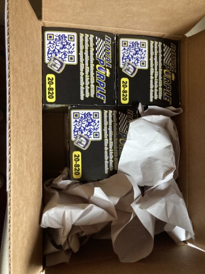

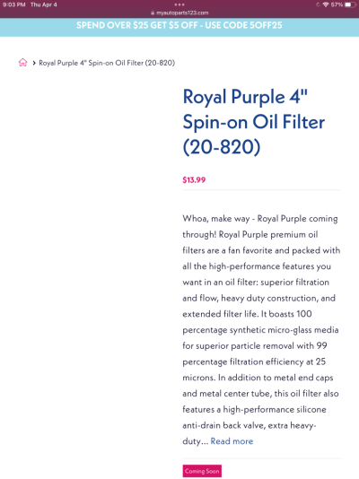

Well, here they are. Again, from MyAutoParts123-dot-com, ordered 04/02/2024, received 04/04/2024, at about 1:45pm via UPS Ground.
FREE shipping on orders of $25 or more. Just about $40 for 3 filters.
Filters well packaged and all 3 look perfect and made in Mexico, exactly like the ones I got from Summit and RP Direct.
Got mine too. From Mexico also

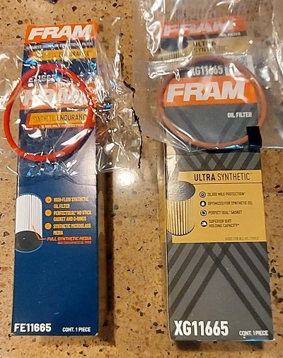

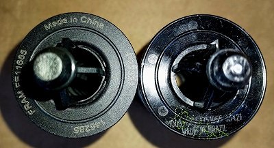

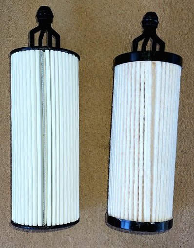

The China Endurance filters came in. Here is a comparison between China Endurance and Brazil Ultra filters for a Pentastar.
The Endurance box is smaller, and there is no tape seal on either filter I received. A cost cutting measure on both accounts, I assume.

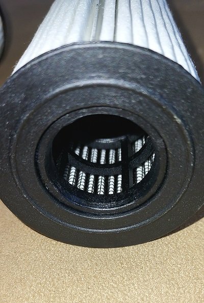

Endurance on the left. The seam appears well sealed compared to the Ultra. The Endurance material is very firm where the Ultra isn't. I hope it's actually synthetic media.
They cut back on the size of the end caps on the Endurance.
The Endurance has a screen in it.

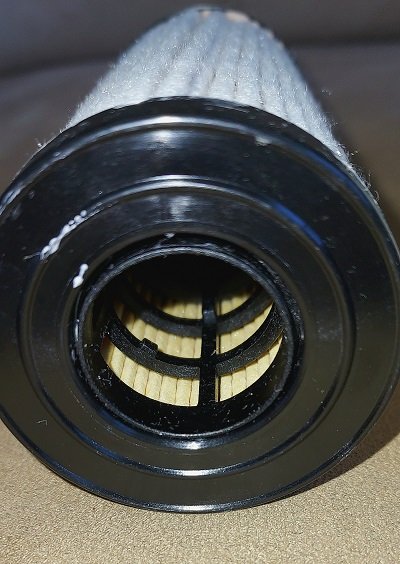

The Ultra doesn't.
What does everyone think? Do either of these filters instill confidence?

I see these have a plastic suction core instead of steel. Not sure that matters as long as they made the plastic thick enough to simulate the strength of a steel core under pressure differential and heat.
They always claimed Ultra dual layer synthetic didn't need a screen owing to the added stiffness of two media layers of differing filtering efficiency, so this is not a surprise.
The Endurance media appears to be all one substrate, and my guess is that it is fiberglass. The fact it has metal mesh screen backing also is evidence for this. I have seen other filters made of spun fiberglass media with media being sourced from China, but filter assembled in USA. In fact, I wonder if Champion Labs filters (Royal Purple, etc.) aren't made this way also?
Who knows how well the end caps seal, but the media itself visually appears the same as OG Fram media.

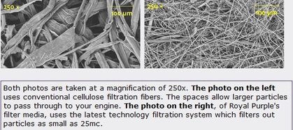

spun glass is microscopic glass, this is 250x, it doesnt need binders that cellulose filters need, it just needs a metal screen to hold it together, those binders stiffen filters with use. If there is a better media, it is news to me. Left side paper, right side microglass. From the gm test to the independent lab tests, it flows better, lasts longer, and catches more contamination, and doesnt blow holes when binded like paper does. I literally think they should ban paper filters this stuff is so good, generally I am not for bans either.
The sadder joke is microglass seams to be on the way out, lol.

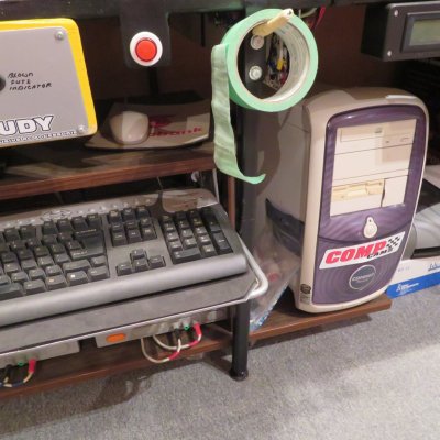

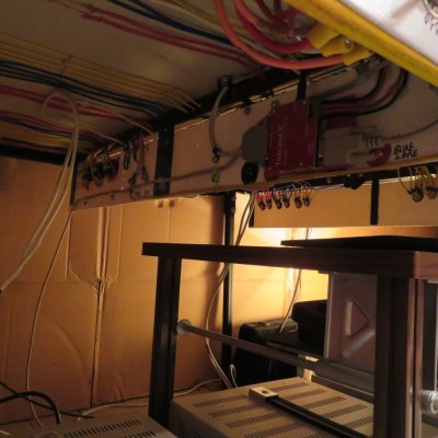

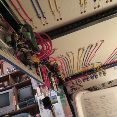

Nice ole trackcar setup there.
I have about a 1,000 hours and a little over $4,000 into building it,lol. It's a routed track that's fully computor controlled,and times down to 0.001.The track is wired for brakes and has a 10 amp power supply on each lane.
