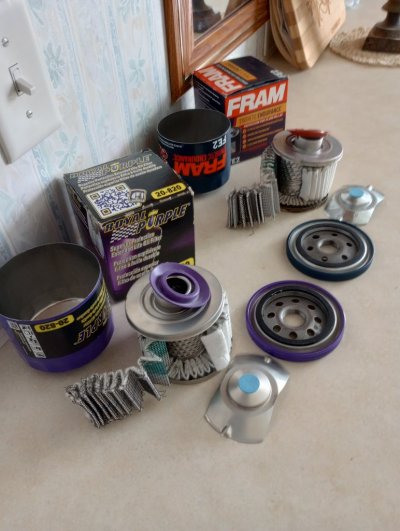

Another pic for visual comparison of the FRAM FE2 SYNTHETIC Endurance to the Royal Purple 20-820 is an carbon copy exact in quality with the difference being the amount and size of the inlet holes, eight on the Royal Purple 20-820 and six on the FRAM FE2.
I would not hesitant to use the FRAM FE2 SYNTHETIC Endurance oil filter. I might give it try and it's cheaper in price and on the shelf at Wal"-Mark" ...
