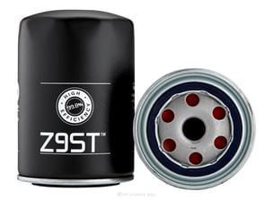

I get that and I appreciate the advice, but that does mean more work, more travel, more hassle hence more time I really do not have at the moment. I doubt there is a farm implement dealer within 100kM of me! And if they are the chances of them being open outside business hours is unlikely. I really wanted a simple bolt on solution that I don't have to even make up an attachment bracket for. I do however really like the idea of the twin imperial thread filters although they are not available to me in Australia in Royal Purple brand. My biggest concern with the Trans-dapt kit is where the two outlets end up when the screw on bit is tight. If they end up in the wrong spot when it tightens it will be very hard to get the right angle pieces screwed into it, and get the hoses to run easily. The Pacbrake unit you can place it where you want and screw the holding nut up.
What would be ideal is the Pacbrake engine end and the Trans-dapt filter housing. Which is do-able I guess, Trans-dapt sell the dual filter relocation base by itself as part number 1030. Would just need some adapters to make the Pacbrake hoses screw into the Trans-dapt housing and make up an attachment bracket. I reckon I could probably even use the Pacbrake attaching bracket and modify it to mount the Trans-dapt filter support onto it.
I wonder if the actual filters used with the twin kit can be a cheaper unit that I can easily get locally. Like these:

... imperial thread filters. Haven't heard that in awhile, usually just standard thread where I'm from.
Most of the world is Metric today. Imperial stuff is still around and entrenched but lost more metric today than anything else. The imperial Z9 filter is a very common filter though, just about every old Ford in Australia used it.
