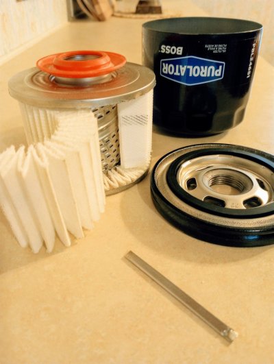

The filter media on the Purolator Boss PBL 24651 is just as durable as the Royal Purple 20-820. I've tried tearing both with my fingers, actually the Purolator Boss with the filter media having the synthetic mesh backing isn't going to tear because of the way it's formed to the media.
... the difference between the two, is the Purolator Boss has an synthetic mesh backing made onto the filter media and the Royal Purple has the metal mesh backing "attached". Other than that, the media is identical in thickness/quality, imo.
In the pics, you can see where I could tear the RP filter media after separating it from the metal mesh backing versus the PB I couldn't tear ...
I used the Purolator Boss PBL 24651 prior to learning about the Royal Purple 20-820 without any issues.

I do not see, after my visual inspection of the Purolator Boss PBL 24651, how the filter media is going to tear under normal use. I could get a pair of pliers and most likely tear it, where the mesh backing is part of the filter media and I can't separate it using my fingers, where the Royal Purple 20-820, the metal mesh backing can easily be separated and I can tear it's media with my fingers.
Under normal use of either oil filter, I don't believe there will be any tearing or separating, both filter media look and feel durable, imho.

So you're referring to tearing the actual media, correct? You have the "ribbon" in your hands all stretched out and you can't tear it.
But what about tearing/separating the media off of the rest of the filter (so how the media binds to the ends and the center tube, is that "tearable"?

Yep, although I came across as it was simple to tear the RP, it isn't. My point was I can tear it with much effort with the wire mesh pulled back off of the media and can't tear the PB because of the way it's filter media and synthetic mesh is designed.

The Purolator Boss filter media is held secure at the top and bottom of the filter tube with oil resistant/high temp glue and has at the ajoining filter media, where the media "ends meet", the are crimped together with a metal "clip" and is resistant to tear or come apart. I can't tear it apart glued/assembled together without cutting it apart. It's very well made, imo.
The Royal Purple filter media and wire mesh backing is "two piece" and held into place to the filter tube same as the PB. I cut it with a pair of very sharp scissors so I could "stretch it out" ...
... and to separate the media from the top and bottom of the canister(s), I used a hack saw, lol.
