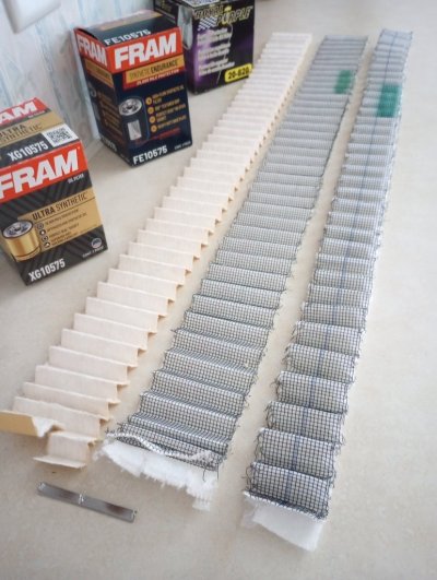

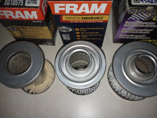

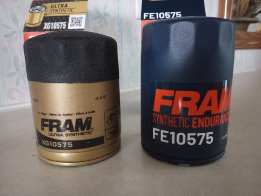

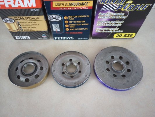

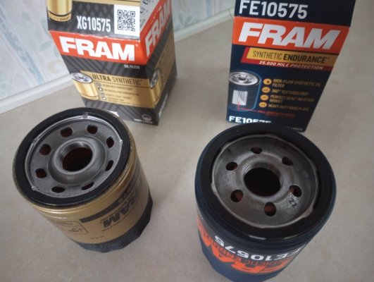

Well, the FRAM FE 10575 SYNTHETIC Endurance oil filter "compared" to the ROYAL Purple 20-820(different applications)is, imo the same in quality and construction. I added the FRAM XG 10575 ULTRA Synthetic for arguments sake.
Pics show left to right FRAM XG 10575 ULTRA Synthetic, FRAM FE 10575 SYNTHETIC Endurance and the Royal Purple 20-820.
• The outer case and base plates on the FRAM FE 10575 and Royal Purple 20-820 are durable and solid where the FRAM XG is a mediocre outer case and base plate. The inlet holes on the FRAM FE SYNTHETIC Endurance oil filter has two less than the Royal Purple and FRAM XG ULTRA Synthetic.

• All three oil filters bypass valves are the same having the plastic valve and spring attached the "leaf spring".
• Filter media on the FRAM FE SYNTHETIC Endurance 10575/Royal Purple 20-820 are well made, wire backing on the filter media and is stated to be of synthetic micro glass, the FRAM XG 10575 ULTRA Synthetic filter media is an "cheap" synthetic/paper blend without the wire backing and is crimped together.
• The "louvered holes" in the inner filter core are the same on the FE 10575 SYNTHETIC Endurance/Royal Purple 20-820, where there are "round holes" on the FRAM XG 10575 ULTRA Synthetic's inner filter core.
Imo, the FRAM FE 10575 SYNTHETIC Endurance is an equal alternative to the Royal Purple 20-500 and is on the shelf at Wal-"mark".
I also thought it interesting that the FRAM XG 10575 ULTRA Synthetic compared to the FRAM FE 10575 SYNTHETIC Endurance are different in height ...

That is so weird Fram made the FE10575 longer than the XG10575! All the other series are the same sizes!
Perhaps they cut back inlet holes in the FE series because it's supposed to be freer flowing media than XG media? I dunno.

Thanks dub, I like those open holes. Is it just me or is it ridiculous in 2024 we still can't get an oil filter with open flow tube and inlet holes and 100% spun fiber?
Yeh, all I could find on the FRAM FE series oil filter is an higher flowing filter and it's a heavier duty oil filter rated for extended oil filtration efficiency @99%(?microns) up to 25,000 miles.
