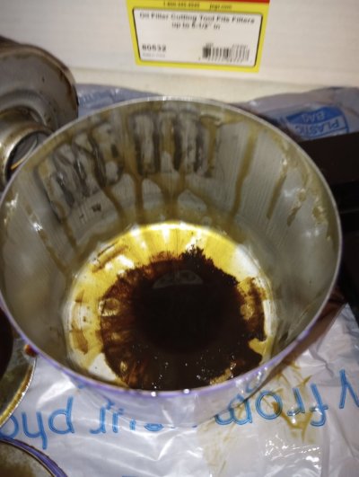

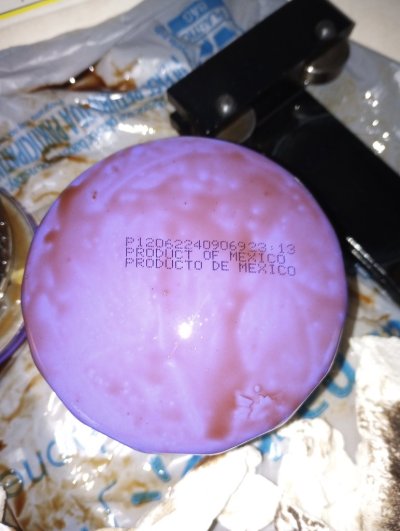

Well, here's a few pics of the Royal Purple 20-820/Red Line 5w/30 oil that had ~3000 miles @ nine months since the last oci on my 2017 HEMI 5.7(June/2023 to May/2024)
I performed my HEMI engines oci a couple of weeks(middle of May/2024)after I finally had it returned back to me after the repairs from the collision were done(Nov./2023). I was almost at "my oci/3000 miles when the accident occurred, so the oil sat stagnant for the duration of repairs.
• First pick showing very dirty filter media with sloppy glueing from Royal Purples contracted Mexican manufacturer ... I didn't know it was sloppy.
• Second pic shows on the inside of the outer oil canister where I had the FilterMag attached and the bottom of the oil canister with some dirty oily black film. I wiped the inside with a paper towel showing the oily black build up on it.
• Other pics are random and shows what would be typical and expected.
My oil report from Blackstone Labs is posted over on the Blackstone Labs thread, shows that Aluminum is @ 9 ppm with the previous average 2 ppm and Iron @ 31 ppm with previous average 11 ppm.
I'll submit another sample to Blackstone Labs on the next and upcoming oci(@ 3000 oci) and will post those results
Hopefully the accident/collision with the eighteen wheeler gravel truck didn't hurt the engine and that these wear metals are high due to things being taken off of the bent frame and onto the new one. Idk.

@JHoward , my immediate knee-jerk impression is that there is quite a collection of nasty looking crud on the inlet side of the filter media that apparently did not make it past the filter media to the other side. It looks like the filter did it's job.

Yeh, there wasn't a cam or lifter stuck it, lol ... so I'm glad the filter did what it was designed to do.
Now, gotta wait a couple of months at the next oci, send the sample in to Blackstone Labs and hope that that the report shows normal wear metals.
