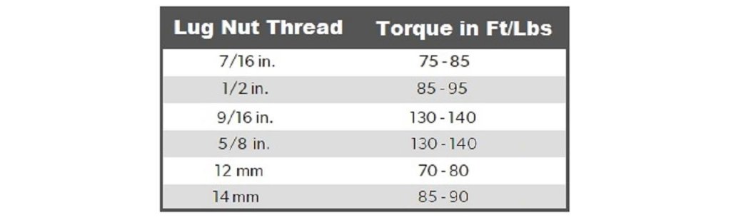

So another thing M14 is supposed to mean 14mm? Just add to the confusion because 14m is meter not mm, especially since most charts don't include 14mm. So what is 14mm in inches? This place has 14mm stud as 85-95, and that cant be right? what the simple kf is going on. knowing more about threads is gonna help with filters.

so 14mm is basically 1/2 inch and all the charts say the same thing for 14mm and 1/2 inch. Clearly something is wrong. It isn't pertaining to my two vehicles so I leave it there, but I'd look into it if my OEM 14mm said 130ft pounds, something is wrong there somewhere.

If you buy Gorilla lugs, who do you listen to, gorilla or OEM specs? Because for your 14 x 1.5 gorilla recommends like 95ftpnd and OEM says what you showed 130. To be honest from what I have seen it is only that size where there is bad info, the standard Toyota sizing is 75ft pounds and most of the larger size are 130ftpnd, but the 14mm is completely whack.

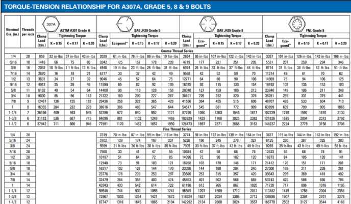

Nope - it's not just 14mm. Either engineers today don't know what they're doing (suspect), or they're using the wrong tables. I could calculate this by hand without looking up T=c*d*F, and we designed the F load.
Anyway, 14mm (0.5512 inch) is closer to 9/16" (0.5625 inch) than 1/2" (0.5000 inch). So look in the SAE Fine Thread table below (the bottom table) at 9/16" threads. Go from left to right from weakest to strongest grade of steel. Torque specs are not constant for a single thread size! They range from 73 ft-lbs to 201 ft-lbs.
You HAVE TO know what type of steel the bolt has. Or you'll under-torque, risking it coming apart, or over-torque and snap the bolt head off. Or hope to god the junior engineer assigned to the task has someone somewhere guiding them. That is usually no longer the case anymore.
Addendum: this chart is from Fastenal, a major worldwide fastener supplier. We used them almost exclusively at one point - no counterfeit issues.
Also I see I'm obsolete, no surprise, SAE Grade 2 has become ASTM 307A, and what the high grade was is now FNL Grade 9, used by aerospace and military.

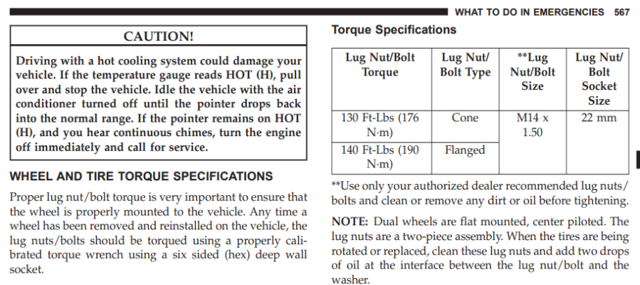

Your only choice is to point out the discrepancy between industrial bolt torque specs with theirs, and ask why.
More important is to look at your O&M Manual. If that torque spec differs from a vendor's, don't use the vendor's parts - because they don't clamp the wheel to the hub tight enough (unless the vendor can claim they are so highly lubricated their recommended torque spec will produce the same clamp load as dry threads with the O&M torque spec).

130 to 140 lb-ft covers both flanged and cone M14-1.5 wheel nuts by my 700 page manual.
Cone calls for 120 to 140 lb-ft
Flanged calls for 130 to 160 lb-ft
