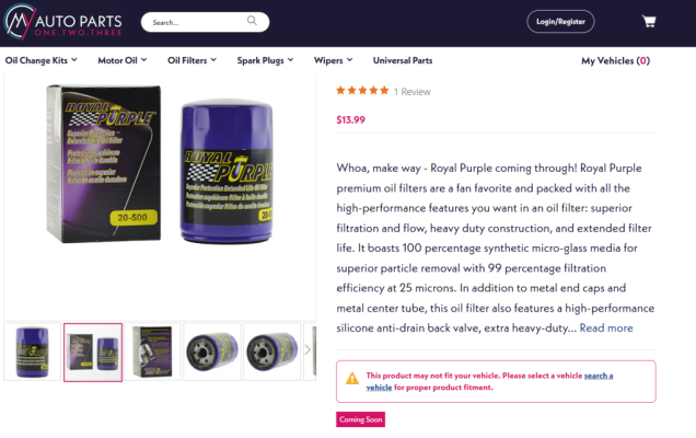

Anyone still order from here?
I'm all stocked so I haven't needed to order lately.
"Coming Soon" :laughing1:
Not lately but I have ordered twice from them and I'm pretty stocked-up on filters right now.
I thought they were awesome. Order processed and shipped typically within 24 hours and I received my order within 3-4 days. Not bad considering I'm in PA and they are in Waterford, Wisconsin.
I still have some of their RP 20-820 filters in my garage. ;)

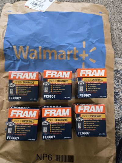

My quick buy for the Japanese engines. I could have bought more, but whatever. Some boxes were beat up but all contained labeled filters so maybe employees have been to check boxes before shipping.

I got to get some for the cross even though I am on the free oil changes another year, might not be around soon then what I still haven't heard what's next.

Yes - idk where or how Walmart is pulling from stores - i.e., my "home store" is set to my closest store, but I don't know if these come off that store's shelves, or from their stock, or from a regional warehouse, or what.

I ordered 3 fe2's from Walmart last night and they were delivered this afternoon. So they had to have came from the store closest to me. Especially since they weren't boxed up for shipping. Just left at the front door in a Walmart plastic bag.
I'm due for my annual oil change in a few weeks. So I've got enough for the next 2 years. After that who knows with this race to the bottom world we live in.

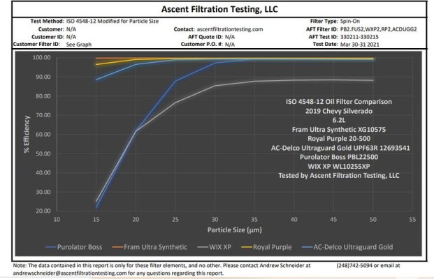

Yeah, the Project Farm guy got similar results except for the Purolator Boss which was a rock catcher akin to Wix, it confused me. So I've avoided Purolator in the meantime not thinking the world was coming to an end.
And - since then, Mann-Hummel bought Wix with purported quality going south. I guess who needs an engine oil filter anymore, eh? It didn't save the GM L87 engines! lol

That graph is even close to being true shows how bad things are on the engine front, if I wasn't all nutted up I'd be buying enough fe2 to last the trucks life, they will store well in an inside closet. Future filters will likely not have the efficiency of those tops filters unless fram survives. You will have 15 micron particles all over the place and worst up to 50 plus with xp and at least 30 with puro boss, while those incredible filters will be gone. With champ labs closed permanently, who even knows if we will ever see a spun glass filters as efficient as the top two and their clones in that graph? Freak'n Jay Pan, quality is dead. Make a lot of money and buy a car every 50k miles, or your an idiot.

Sorta why I've been poking around Fleetguard, which it seems is still running in Mexico (they moved from Iowa to Mexico a little over 10 years ago), and Donaldson, of course - which seems to be one of the few well-managed companies left and manufacturing in USA.
And let's remind the members that most engine damage is caused by particles between 5-20 microns. Bigger is too big (and easily filterable), small is silt filtration needed for HPCR diesel fuel, not engine oil - these particles easily flow through moving machine elements and don't wear the surfaces. So the exact filtration we need is the exact filtration they're removing.
Perfect.
